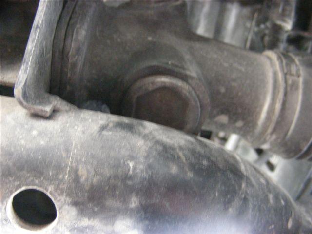

I haven't really measured it. But my guess would be some where around an inch or so. I don't know if that helps. No I haven't compared it to other Delica's.
This is the only thing I can see that might be used for adjustment. Is this correct? Looks hard to get at.

Re: Steering adjustment?
Delica's don't have steering box,it's rack and pinion and as far as I am aware are not adjustable,I'm sure someone will correct me if I am wrong !!!
Mick.
PS I think there is a coupling joint or 2 on the steering post (can be seen from below ) may be flogged out ???.
Mick.
