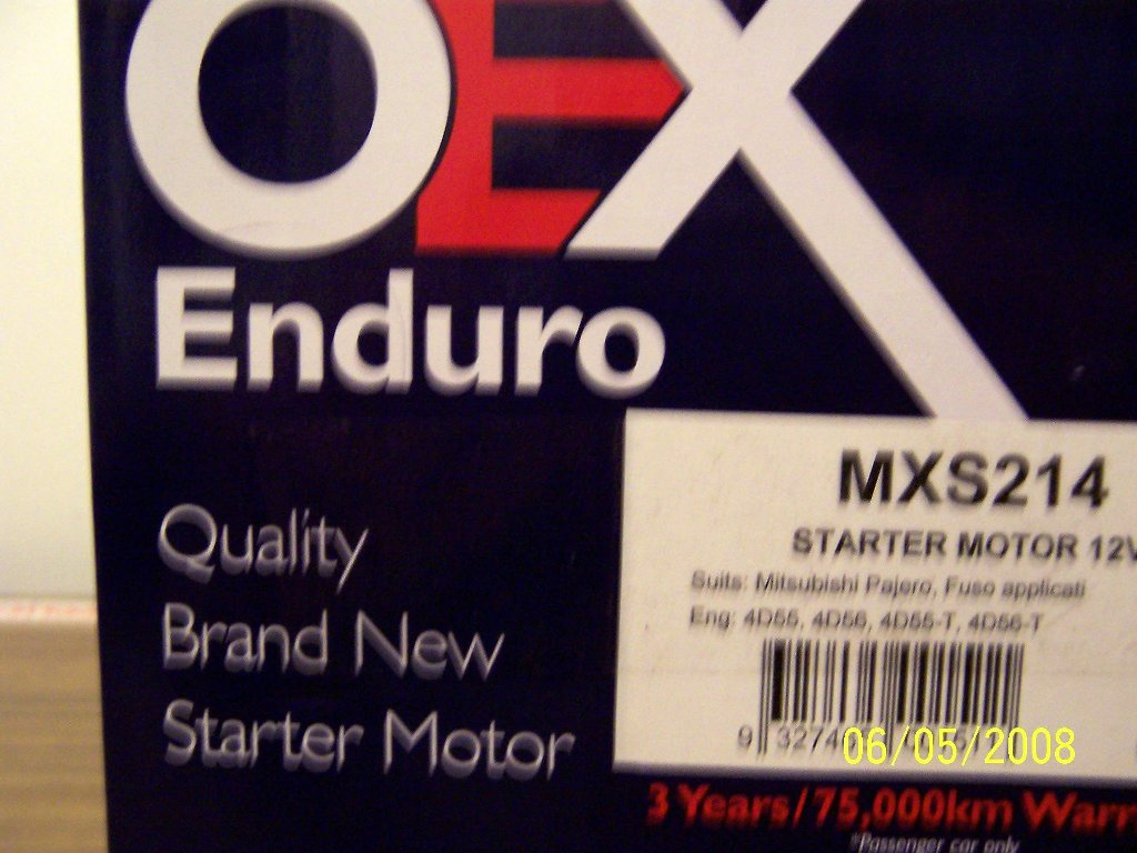

G'day Twisted,the solenoid can be replaced separately but can't help you with a part number sorry,but I did replace my starter with a non Mitsubishi make called ENDURO OEX I think it may be a American brand ?? here is a photo with part number hope it is of some help,it cost me about AUS$350
