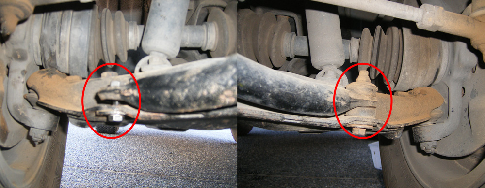

I also lost a nut/bolt assembly and some rubber cushions from this rod up front. I replaced the bolt/nut, but I was going to wait until the CC Auto meet before I replace the rubber cushions. I doubt this is related to the squeaking problem which happens at idle as well as driving.
Here's the video I shot trying to illustrate the squeaking sound, any ideas? You think it is safe to drive from Nanaimo up to Coombs for a check up?

you're missing a poly-urethane bushing underneath, cheap fix, 5 bucks plus labour, get both done at the same time, they notoriously crack, and you'll definitely hear clunking when you turn corners. don't know how safe it would be to drive without one.
