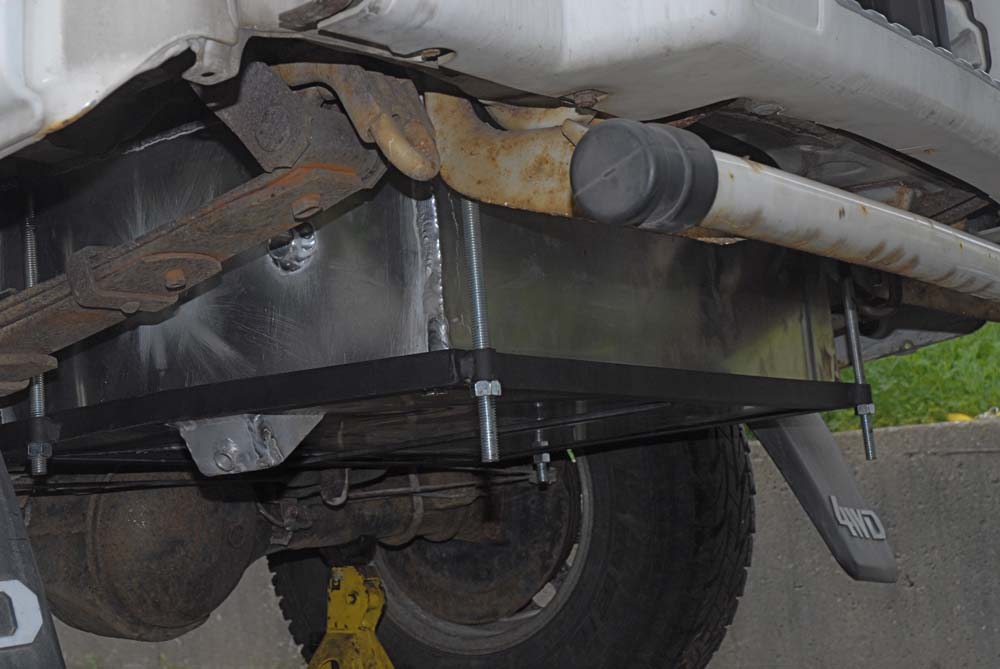

Is there a way to tack weld or loose the threaded studs hanging down on the rear ?
With my off pavement driving style, I'd be worried about ripping them off and the tank slipping out.
The kit looks really good Andrew.
AndrewH
- Posts: 81
- Joined: Fri May 23, 2008 5:20 pm
- Vehicle: toyota surf TD
Re: Deli WVO kits are now available!
I agree,jfarsang wrote:Is there a way to tack weld or loose the threaded studs hanging down on the rear ?
in the instructions it says to replace the nuts used to initially install the tank with lock nuts and then trim off the extra threads leaving about an 1/8" or so of thread showing.

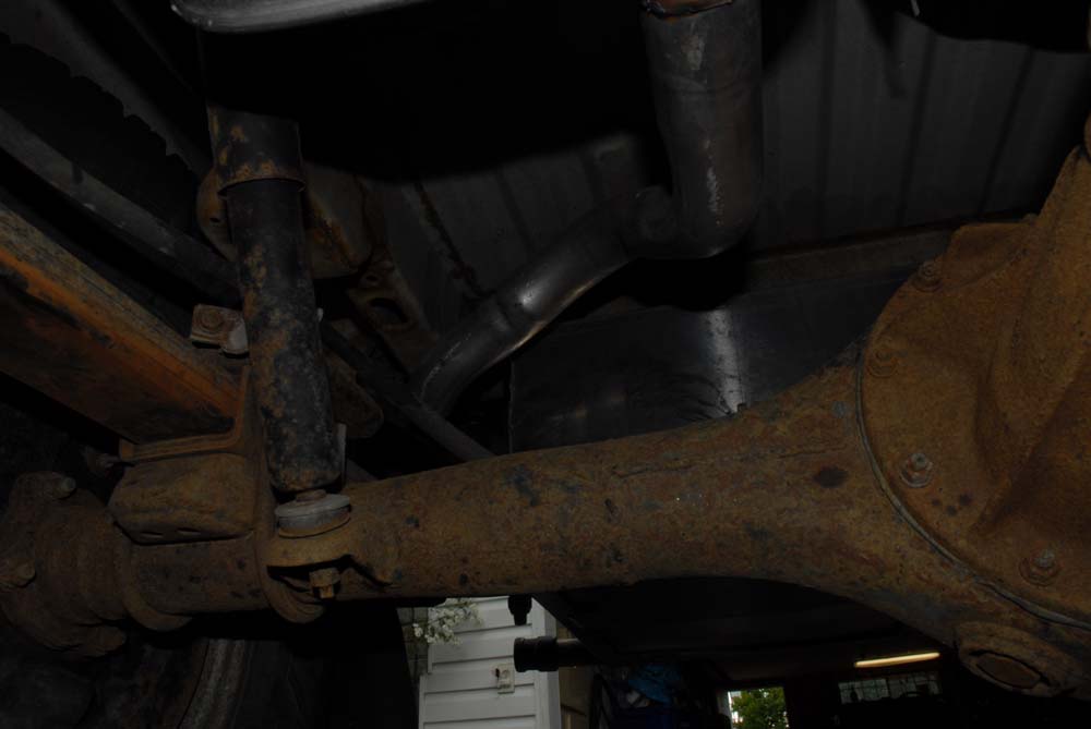

A note to anyone that has a sway bar and a hitch (mine's an E&H custom build): you'll have to remove the hitch temporarily to get the sway bar down (for drilling holes to mount brackets) since the hitch uses the sway bar attachment points as well, and pretty much have to go with a side-exit exhaust, unless you're willing to do some tricky bending and run the exhaust over the spring... The hitch is pretty heavy and awkward (mine especially since the wiring is attached) and it takes 2 people and a floor jack to get it back on. The tank itself fits inside the hitch, but the coolant connections on the side don't quite fit, so a slight re-design is being done.
Otherwise it's a fine looking kit and I hope to be up and running in the next few days.
PS. I found that my spare fits well underneath the rear bench, although outside the vehicle somewhere would be better it's pretty unobtrusive there and isn't using up much useful cargo space.

new tank is done,Schwa wrote:A note to anyone that has a sway bar and a hitch (mine's an E&H custom build): you'll have to remove the hitch temporarily to get the sway bar down (for drilling holes to mount brackets) since the hitch uses the sway bar attachment points as well, and pretty much have to go with a side-exit exhaust, unless you're willing to do some tricky bending and run the exhaust over the spring... The hitch is pretty heavy and awkward (mine especially since the wiring is attached) and it takes 2 people and a floor jack to get it back on. The tank itself fits inside the hitch, but the coolant connections on the side don't quite fit, so a slight re-design is being done.
I am thinking that I just might start making all the tanks with the coolant fittings coming out the front so no issues with hitches will come up.
for the exhaust you can buy some $8 45* 1-7/8" exhaust elbows from canadian tire to fit your exhaust. I just did this yesterday and the install looks like it came out of the exhaust shop!!!!!
it will be tight but easy to do if you have someone hold the pipe in place while you tack weld it together.
Andrew
