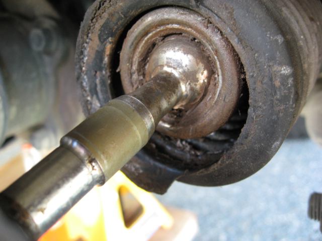

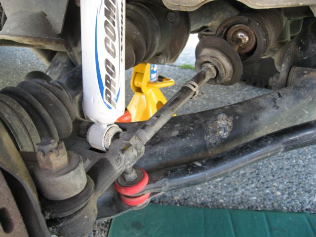

rdub
Posts: 261
Joined: Wed May 23, 2007 7:18 pm
Location: aldergrove
Re: clunking front end
Post by rdub »
Heres the deal. (problem) :?
