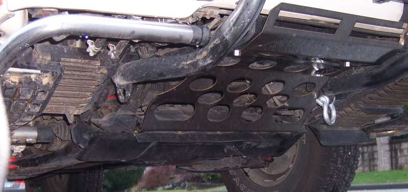

Here's a picture of the two front one. You just need to add some (I forget what they are called but as you can see one anchor has one and the other doesn't). Shackle?
Picture 1.jpg (114.43 KiB) Viewed 6919 times
That simple. And Green1 provided more info that will help you...

one thing to be careful of, the mitsubishi manual specifically states NOT to tow from those points as they are tie-down points and now tow points... that said, I can't see any reason they wouldn't be good enough...
Re: Where to put tow points
What would the tie-down be used for? I've taken my truck and a few others out of sticky stuff using those and they did the job. I can see how they suggest using the bull bar but it's similarly attached to the frame... Soon I'll have a hitch there anyway so won't have to worry as much on those tie-down vs tow points. 8-)

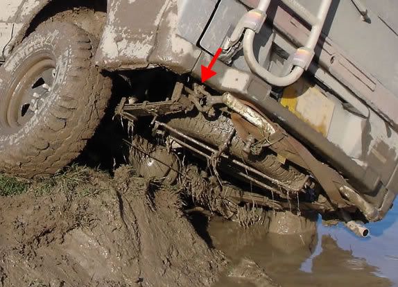

The only photo I can find which shows the location (I don't often point a camera under its arse!)

Green1 wrote:
On the towing eye which is under the rear bumper on the passenger side (big hoop coming down off the chassis rail)
word of warning here, there is also a hole in the chassis rail slightly forward of that loop, it is NOT strong enough for towing (someone prior to my owning the vehicle tried it, it tore the hole open)
Not sure what you mean by that?? The rear towing eye is about as strong/strengthened as you would ever need it to be.
I have just been out and checked all 3 of mine and there is no hole in that area....just LOTS of welded metalwork where the bar for the towing eye is welded around the shackle mount and chassis rail. If you pull this out, you're pulling the leaf spring out and the rear of the chassis too!
I've had to do about 12 snatch recoveries from this towing eye and plenty of heavy pulling on bogged down Pajero's....(and I mean serious pulling) and not one sign of stress/damage/weakness.
Are you sure some previous owner hasn't cut a hole there for some reason?? Sounds a bit odd to me?
Green1
Posts: 3257
Post by Green1 »
The tow point is fine. the problem on my vehicle is that someone ignored the perfectly good tow point and hooked in to a hole on the frame rail instead, these are NOT strong enough and obviously tore out.
