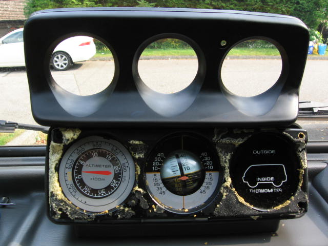

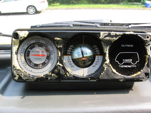

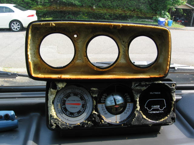

I pulled at the rubber cover and it came off with an unfortunate ripping noise, and left some of its foam behind. So now the unit looks like this:
This is without the rubber cover.
With the rubber cover above:
I still don't see a plastic flap, and now I have to re-glue the cover...
A little help would be greatly appreciated. Thanks. :-)

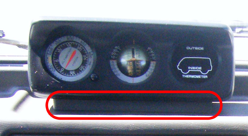

The plastic molding is at the base of the pod and covers up the screws you need to undo to remove the pod.

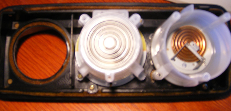

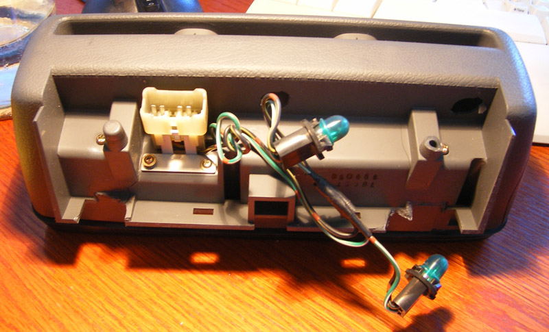

Here are some shots of mine partially disassembled:

Mine just came off with gentle pressure from my fingers. There's only small little clips holding it in place. ONce it's off you'll see the little screws....

Yep. Got it off. And it looks like the inclinometer is without fluid. I wonder if I need to buy a new unit?
EDIT: scratch that. When I hold it over my head I see the fluid... and little pieces of plastic floating around in it. Looks like something broke all right, but I have no idea how.

The Pinkfingers wrote: What plastic flap??
Am I a bad person because I couldn't help myself laughing out loud when I saw this picture? Sorry, just looks like something I might've done myself...
