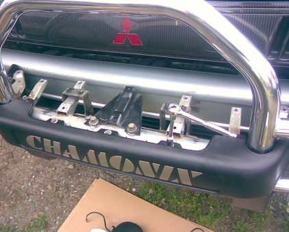

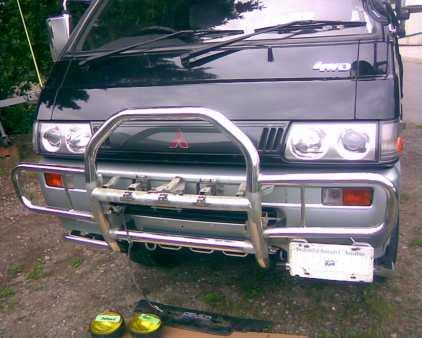

Front bar is dead easy to remove.

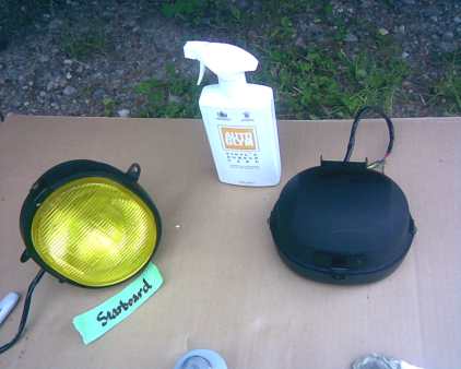

From underneath, reach up under the shroud and disconnect the fogs, then unbolt them from underneath and remove them.

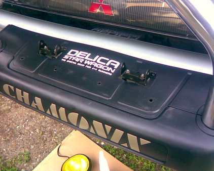

Once the fog lights have been removed you can remove the top panel of the shroud simply by lifting/popping it off. Make sure you don't lose the 'half moon' trim where the upper panel meets the bull bar.
Look down inside the shroud and you'll see two bolts on each side that need to be removed (quite tucked away) - treat these with a good dose of penetrating oil and leave to soak for a while. This is a good excuse to go make yourself a nice cup of tea (or whatever you guys drink over there!)
Once you've drunk your beverage and while the penetrating oil is still doing its stuff, from underneath follow the lower main bars back to where they are bolted to the chassis leg. Remove these two bolts (1 x 14mm bolt each side)
Now return to the four bolts inside the shroud. Undo these using a 14mm socket and a long extension.
Now lift the bar off the vehicle but make sure you go careful that you don't damage any of the AC pipes with the right leg of the bar as you lift it out....
If you want to remove the shround itself, simply unbolt it from the bull bar - this is done more easily when it is off the vehicle. If the bolts look/feel siezed then treat them with a god dose of penetrating oil and leave for a while.

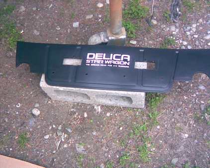

Painting the bar is straight forward, but I wouldn't really recommend painting the shroud - it's a funny plastic and you'll need to use special primers to get paint to adhere and even then you should use special plasticiser in the paint to allow it to flex.
The best thing to do with these shrouds is to restore them back to their original colour by blasting them with a heat gun. With a bit of prcatice and some patience you can turn a light grrey very faded shround into something to be proud of!

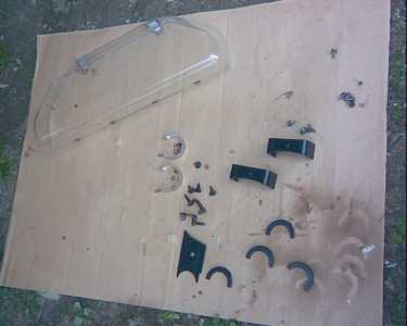

The cowling over the bambi bars is held on by roughly 19 screws and about five snaps. First you have to remove the bush lights (eight screws) and in order to do that you first have to disconnect them. This is done by lying on your back, looking up into the assembly and there is a wire that is held in place by two bendable hooks ~ when you see the wire just run your fingers over it and you will find the hooks, bend them back and free the wire. Now it is easier to disconnect the plugs (two each). They look like micro Xmas crackers ~ pinch both ends and pull (they don't go bang, mind). Now undo the screws holding the lights and the mounts for the lights.
Cowling removal.jpg (20.03 KiB) Viewed 5803 times
Bush Lights.jpg (14.72 KiB) Viewed 5803 times
Note from these pictures what the light plugs look like.
Next is the lid which is held on by about five snaps that are attached to the bottom, on the body side of the lid. It looks like this:
Cowling Lid.jpg (22.55 KiB) Viewed 5804 times
The forward lip of the "lid" is tucked under the main cowling body so you lift the rear end of the lid first then slide it out and you should be left with something like this:
Cowling with lid off.jpg (19.45 KiB) Viewed 5803 times
From this picture you can see where the snaps go and that they will be located in that corresponding area under the lid.
As you take it apart there will be a number of small pieces ~ don't loose them.
Cowling Pieces.jpg (9.44 KiB) Viewed 5804 times
From here you will see how the Cowling comes out. There are smaller pieces that are held on by one screw ~ I would leave them for last. Once unscrewed the cowling should pretty much slide out forward. If your van is like mine you might find that the screws may be a little seized with age, avoid stripping them or snapping them as I did to one!
Once the cowling is off the bambi bars will look like this:
The Bambi Bars.jpg (29.29 KiB) Viewed 5803 times
The bambi bars are held on by six bolts: Two upper left; two upper right; one underneath left and one underneath right. That should remove the bambi bars.

P.S.: There are products on the market that will totally rejuvenate the vinyl, rubber and plastic parts of your van. "Mothers Back To Black" is one: Ten bucks at Lordco or Cdn Tire. Autoglym is another (as seen in photo with lights), you will find that at a place called "Overseas Auto" on Fourth and Main in Vancouver. It is around fifteen bucks. When I got the Miss Lil' Bitchi, all the plastic, vinyl & rubber were heavily greyed and streaked ~ I have used both products and I would go with the Autoglym. It costs more but it is a superior product.

I tried the "Mothers" on the rear mirror, MM and to no avail. Mind you, I had tried the Mothers on the fogs and that was the same result but when I used the Auto Glym on the fogs they both went black so one of these days I will try the Auto Glym on the mirror. I have much of the Auto Glym line and I too think it's the cat's arse. I understand that the Queen is out using this product on her Jags every Sunday. I first discovered this product when I was painting goalie masques (hockey) and then I stopped painting them (no money in it) but I remembered the Auto Glym. Over here, it is not so readily available but there are some places where you can get it.
