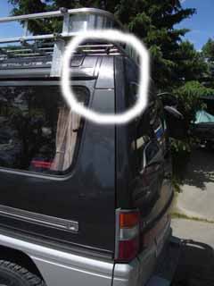

Now that I have my new rack, I need to wire the lights. I want to run the wires down under the trim panels that are at the top rear corner of the Delica:
The plastic is held on with two screws ...

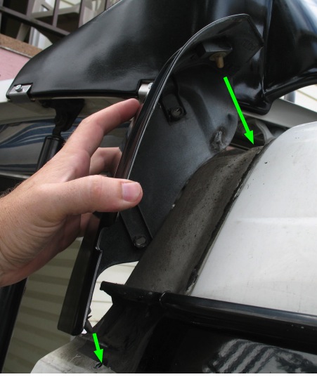

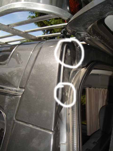

Through some modifications of my own, I figured out how to remove those trim pieces. Here:
  • -unscrew the screws (obviously)
    -slip a long flat-blade screwdriver under the upper edge and pry up evenly
    -slip a long flat-blade screwdriver under the lower edge and pry up evenly
    -ta da!
Now for some pictures:

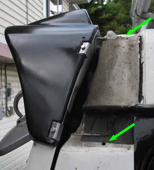

Pry upwards and evenly with a long flat-blade screwdriver in these areas.

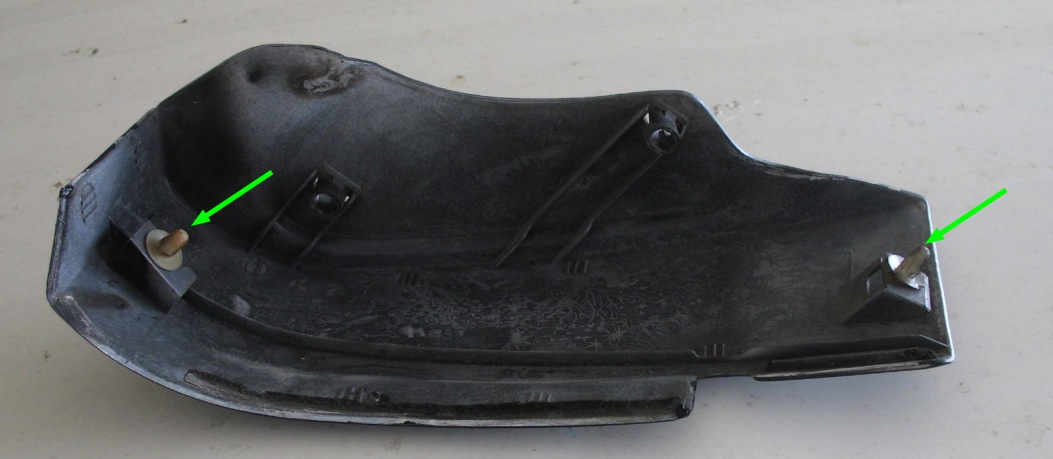

These are the plastic posts which are holding the piece in place.
When remounting, put the posts into the holes, and then screw it up once again.
If the plastic posts break (as they just might given their age/brittleness), one can find something similar from Lordco. Don't bother looking for 'Mitsubishi' ones, just find something which looks similar in shape and length (this is what I used for my rear gate light bar job).
