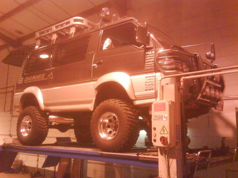

I've been running a side exit on the Mystery Machine for about 3 years now and just LOVE the sound it gives out! A deep, low, resonant menacing rumble. It doesn't sound like a diesel, nor a V8 - just a nice 'mellow bellow'.
Mine is a silencer from an R33 Skyline GTR and I had the pipework cut off and a new 2.5" SS pipe custom made from the downpipe to the silencer. The silencer has a 5" tailpipe which is a 'bit' crazy OTT - but for some reason it kinda looks right/in proportion on a vehicle with such a lift/big tyres. Either that or I'm just so used to seeing a cartoon sized 'zorst on it now?? 8-)
I'll have to get some proper shots of the system sometime.
The only downside I have found is the amount of soot build-up you get on the rear wheel and suspension. It only happens or becomes really noticable over a long period of time (mine doesn't smoke much at all) and would probably be far less obvious if I actually washed the motor more regularly than once every two years...
Here is a shot of the rear wheel looking a bit blackened and sorry for itself.
Up close its also quite pitted from all the soot ground into the alloy, but a few hours with some cutting polish should sort it out. I really ought to clean the soot off more often...and I think I will do it sometime soon to get the alloys looking nice & shiny again but like I said, this is the only real downside to have a side exit.
As for fuel saving, I wouldn't have a scooby because when you're running 33 mud's, big roof rack, roof lights and all other manner of accessories that don't exactly help the already box like aerodynamics of the thing then it's kinda not worth bothering. I just fill it up and drive the thing... :-D

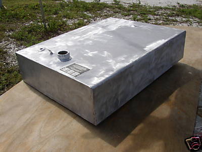

The other bonus you gain from a side exit is more room underneath to fit more toys/accessories.
Re: Delica 304's final word on his 2.5" side exhaust.
Mystery Machine wrote:The other bonus you gain from a side exit is more room underneath to fit more toys/accessories.
Like this :mrgreen:

8-) 8-) 8-) SWEET! 8-) 8-) 8-)
.......or something like this:
(or plenty of other things that I've got planned for the Mud Monkey!)

Forgive my ignorance, but WFT is that? Are you converting your Deli to an electric hybrid lol.

MM: I think that extra room has little to do with the exhaust, and much to do with the spare tyre being on the roof...
I am actually looking to make a similar "electrics" box to what you have, however I'd rather leave my spare under the vehicle, and I'm having trouble figuring out where else to mount things....
Mystery Machine
Posts: 510
Location: Bristol (UK)
Post by Mystery Machine »
The standard exhaust route actually runs straight through where the side of the box is, so a side exit was the answer.
If you look closely at the picture, you can see the space where the original silencer (muffler?) would have been - there is plenty of room around there for mounting an electrics box. This will leave you room to keep the spare where it is.
G-Man - the box houses my inverter, my mains 'hook-up' 240V system/consumer unit and my 12V charging/power system.
I wanted to keep the interior as free as possible from accessories which eat into the space and can look untidy. Mounting it all underneath in a waterproof electrics box was the obvious answer to me.
When I go camping, I can plug the on-site electrics feed straight into the blue socket on the rear bumper. This powers everything in the box, charges/maintains my two batteries and also powers the 12V accessory system on the vehicle (stereo etc...)
It also gives me 240V inside the vehicle (2 x mains sockets set into one of the side panels) so I can use a kettle or any other mains device I want. I've also got another blue socket on the rear bumper where I have a 240V output from the motor so I can run power to a seperate place like a tent etc...and run 240V items from there too...
The inverter is used for running power tools etc...when I am out & about - or for people to run a laptop in the back when I'm on the move. The inverter has its own mains socket (next to the other two) in the back of motor and the system is designed to automtically switch off the inverter if it senses the hook-up socket has been plugged into the mains. Pretty useful.
I've got tons of photos of the system, install etc...if you wanted to see them? (would post them in another thread)
Let me know if you are interested??
