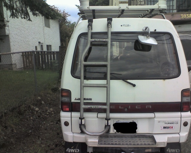

Does anyone out there have photo/link of a high roof spoiler/terzo ladder combo.Ive got the ladder insalled off to the left but to insall the spoiler I think it will have to be centered thus blocking the licence plate. maybe a different ladder would be the answer. any help would be greatly apreciated. Also we got a wooden lunch table with cup holders , was this a stock item? Ive never seen them mentioned or a pic of one in use. Thanks ,

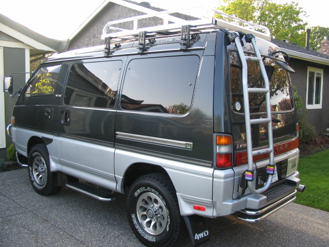

here is where mine is located with spoiler.
btw, anyone know a good place to start looking for a new rubber stopper for the top of the ladder? there are 2 and I'm missing one :(

The 'standard' Terzo ladder for a high roof will fit perfectly with a genuine OEM spoiler.
Paul (sayulita101) your ladder looks like it has been mounted a bit too far over to the left of the tailgate and this will affect the fitment of an OEM spoiler. In Loki's photos you can see the ladder is positioned further to the right which gives room for the left hand 'foot' of the spoiler. Here is a close-up of where I had mine mounted before I sold it.
Looking at the upper mounting brackets, they don't look correct/sit right compared to the other high roof brackets I've seen and this might be because it's too far over?? (difficult to tell from your picture) Have a close look at this and compare with yours....
I notice that you have the rear number plate 'garnish' surround - quite a rare accessory from the options catalogue! This might be one of the reasons your ladder has been moved so far over??
In answer to your question - yes you should be able to fit a spoiler to your motor with that ladder - but it will need to be moved over a bit if you can? (5 min job)
Please can you take some more shots of the ladder & some close-ups of the brackets so I can see exactly what's going on and why it isn't sitting right??
Many thanks,
Bruce.
Many thanks,
Bruce.

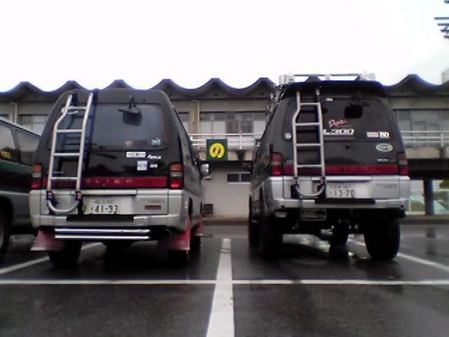

Basically there are only two 'proper' models of Terzo ladder for L300's: a high roof (like yours, mine, Jesse's etc...) and a low roof one.
Loki's is more than likely an L400 one. I'd put money on it. They only have three rungs, not four and also have the dog-leg on the right because they mount on the drivers side (parking mirror on the passenger side on L400's) and I have seen a whole load of different Terzo's fitted to L300's but there are only two versions specifically for the L300.
The low roof ladder is almost identical to the high roof one except that the vertical bars are slightly shorter above the top rung. The top brackets are also different due to the different shape of the roofline. Take a look at the picture of the low roof ladder I am restoring for the new Mud Monkey, you can see the shorter verticals and different contour on the upper brackets:
Anything else you see is from a different model that has been fitted or adapted then fitted to an L300.
Sayulita101's ladder does look like a proper L300 high roof ladder but the feet don't seem to be sitting right on the roof. This may be becasue the ladder is too far over, but as you say, it's hard to tell anything from that angle hence why I asked for more photos.
In answer to the original question: Can an OEM spoiler be fitted with a Terzo ladder....then these pics from my 'archive' may help answer that question:
Seeing as you guys haven't had much to do with L400's over there, I thought I'd include a pic of a standard Terzo L400 high roof ladder in case Loki wants a closer look to see if his might be one of these?? I've restored 'quite' a few now and custom polished quite a few more!!
L400 ladders are much more available here in the UK than L300 ones
....and the L400 owners seem to like giving me money to trick them up! I'm not complaining

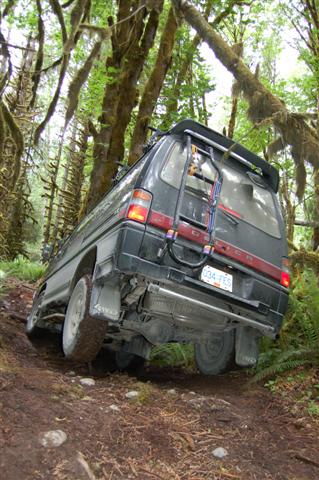

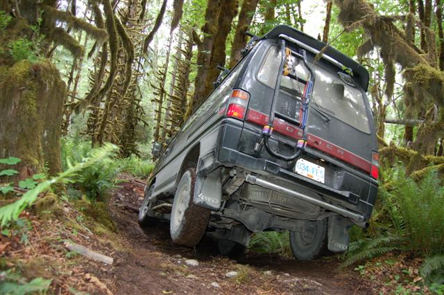

So how much are those bad boys going for? I would love to get a ladder and roof rack for mine, makes it totally look like an expedition vehicle, not to mention very practicle.
On another note I was amazed to see the difference in the rear suspension articulation between Loki and Bruces pictures(third one down). Shows what can be accomplished with some (probably alot) of mods.
Cheers Gary
