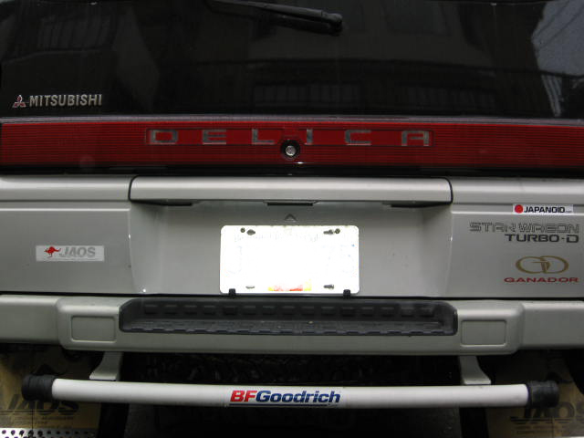

- The Pinkfingers
- Posts: 483
- Vehicle: '94 Exceed
- Location: North Van, BC
Re: Removing Stickers
I don't think I want to take a blade anywhere near my Delica. I don't trust myself enough.FalcoColumbarius wrote:
I have a question for you: Are these Japanese stickers that you want to remove? I only ask because I feel that they add character to the van ~ but of course this is my opinion and everyone has their own taste.
Respectfully, Falco.
P.S.: Razor blades are very good for removing paint, too ~ so again be careful... smiles.
There are four stickers on my Delica. Only one I really want to remove, but even if they all stay I can live with it.
1. A "Japanoid" sticker.
2. A "JAOS" sticker. Again, my wife thinks it adds character, so it will probably stay.
3. A "Ganador" sticker. They are a Japanese company that do after market mirrors and such. I'm OK with it staying, though the right side of the van is looking a little cluttered.
4. A "BF Goodrich" sticker. This is the one I want to go. The silver lining is it's not on the rear hatch - it's on the white bar beneath the bumper.
I'd like to remove the Japanoid and Bf Goodrich stickers, and put a new Japanoid sticker where the BF Goodrich sticker is. I think I'll go with a hair drier and Wax removal oil to start with.
But it's not the end of the world if they all stay.
EDIT: BTW - it's an Exceed, not a Chamonix - it just has the dark paint of the Chamonix.
You're lucky!!
The Japanoid sticker would have been added very recently, so will come off very easily (the glue won't have hardened/set properly yet and the plastic film will still be very flexible) Hairdryer will do this easily - then use lighter fluid (like for filling Zippo's) and a clean soft cloth to remove any sticky residue. (I apply and remove a LOT of vinyl graphics, so I know what will work for you...)
The BFG stickers might be a bit tougher to remove having probably been on there longer, but then it's on the bumper bar that is powder coated, so the paint finish is tougher to start with....again, hairdryer is your friend! Make sure the metalwork gets nice & warm before trying to remove this one.
If its been on there a while, you might find it leaves a whiter mark on the bar where the surrounding white paint has dulled in the sun/elements. A quick rub with some rubbing compound along the bar should cure this.
If you need any authentic Japanese logos let me know, I've got a whole load on my computer that I converted to make on my vinyl cutter (I've even added the 'Off Road Express' logo to my collection - thanks for the photo Kev....
On that note, if anyone has a Japanese logo they want copying/reproducing, let me know and I'll see what I can do??
