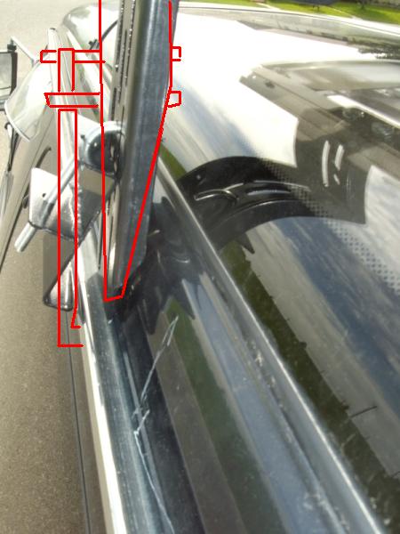

A few weeks ago, I bought a roof basket from a fellow Delica owner and I finally finished installing it yesterday. Putting this heavy thing on top of the car was difficult and frustrating as I initially thought it was not the right size for it, but eventually I realized that all I needed to do in order to make it fit was to untighten some of the screws, and I discovered that this thing was in fact good for a high roof Delica.
However, the "feet" that attach to the gutter can pop out easily (see pic). I was playing with the screws trying to get the feet securely attached, but I was wondering if anybody has any experience with this kind of roof basket and can give me some tips.

Let me try to explain better...
The foot rests inside the gutter: This is ok, no problem here.
The movable clamp is attached to the foot (long silver screw in pics) and is supposed to attach to the bottom of the gutter" Here is the problem. The clamp pops out of the bottom of the gutter. Maybe if I add rubber between the clamp and the bottom of the gutter, this will help?
I'm adding some more pictures to try to clarify. The gray rubbery thing I added to try to protect the paint, but it was too late as I scratched the van pretty bad... :-(

looks to me like the hook that goes under the gutter needs to be bent more, the angle it is on is allowing it to slip off, just my opinion.

That clamp bracket setup is not made for this gutter. It's evident by looking at the side-view picture.
You can probably get away with spacing it out with a longer/bent bolt but then you're shifting the load across a longer bolt/washers.
It's a very poor design to begin with because the tighter you go, the more stress you're putting on the bend on the bolt.
The L-shaped foot bracket looks like it's made for a light-weight load (ie. 150 lbs max). I can't see any reinforcements on it.
Looking at the angled section that points down into the gutter, it has been modified to clear that van body.
Not trying to be a bummer but I would hate to see someone overload a rack and watch their gear sprawling out on the door through their rearview mirror. I've seen it happen on a trail run.
It doesn't look like this rack was made for this type of vehicle going by your pictures.
My 2 cents.

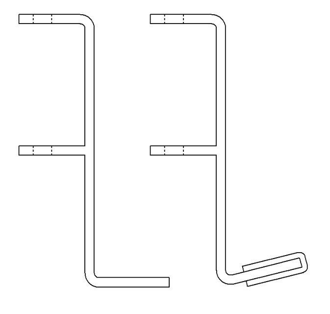

Re: Problem with roof basket
Post by Mystery Machine »
loki wrote:looks to me like the hook that goes under the gutter needs to be bent more, the angle it is on is allowing it to slip off, just my opinion.
Exactly what I was going to suggest - take all the hooks/clamps off and bend the 'hook' part up....and also add the rubber sleeve if you can (more grip as you say) Something like this should see you good:
I hope the image makes sense??
They're not the strongest of racks, but this will be a suitable solution....
