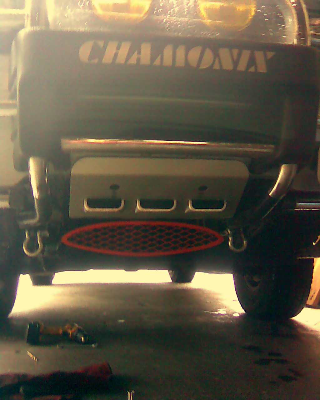

After much deliberation regarding that ominous space between the lower skid plate between the front wheels and the "breast plate", where you can see the oil & engine rads, hoses &c...
I present to you....
The Gopher Grille.
Gopher Grille IV.jpg (64.86 KiB) Viewed 6565 times
I figured that not much would go up there in the way of rocks and the like. However, I felt that branches and marmots could be a serious threat. What are the odds? Not a lot. How far is the walk out of the toollies should this situation potentially occur? Hmmm.... What are the chances of retrieving my van if I left her in there, unattended for a couple of weeks, or however long it takes to retrieve her? Hmmmmm......

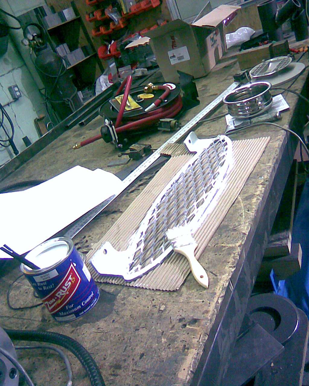

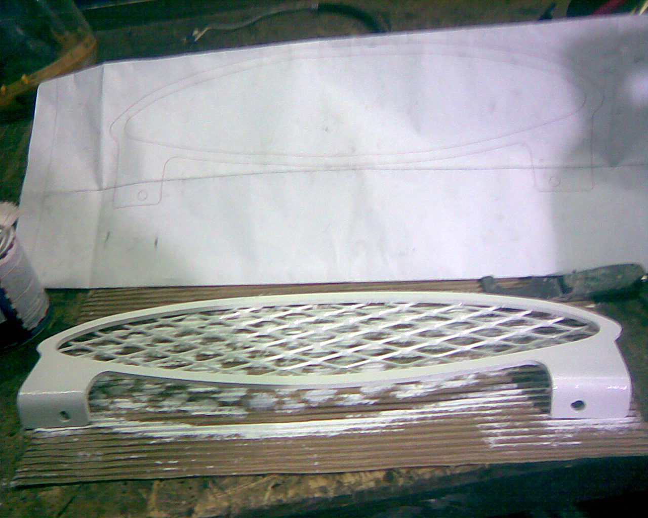

One can only prepare so much... One should not mentally live in a plastic bubble but having seen the posting by (I think) Sasquatch Hunter about the jeep with the branch through the floor boards ~ I thought more about it.
Gopher Grille III.jpg (94.98 KiB) Viewed 6561 times

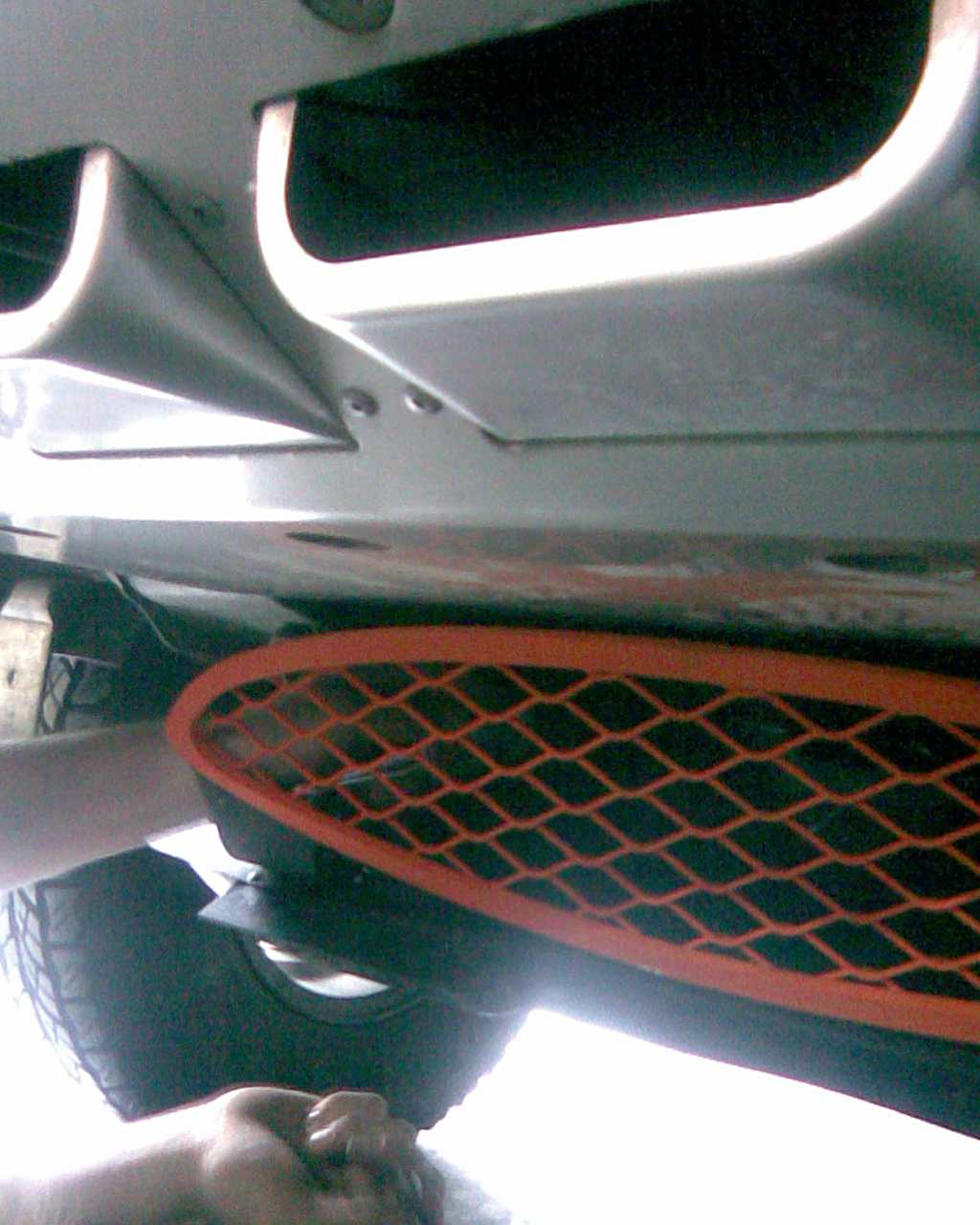

The Grille is attached so that it springs if it is hit, there is about 3/4s of an inch of gap between the top of the grille and the bottom of the breast plate worth of give. It is 1/4 inch steel, cut on a plasma cutter, the tongues are bent in a press, 3/4 inch expanded metal grille is welded into place. I primed it with an anti-rust primer, painted the tongues in flat black to hide them and painted the grille itself in flat orange (because I wanted to make a fashion statement). I decided not to powder coat it because (a) I couldn't justify the cost, (b) I will be painting it again.... and again.
