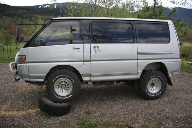

So here it is, I was going to hold off until it was all done... but things keep taking longer and I have been getting some griping people (Kev thats you) begging for pics.
New tires vs old tires...

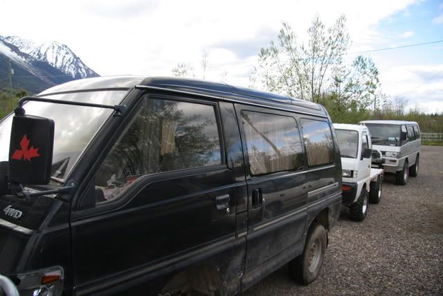

The Delica and my other distraction
My three beloved vehicles (although one is getting stripped down soon)
Anyhow, I love it, haven't named it yet, and have lots to do still. The garage (and Jame's garage) is full of parts for it. So far the only mods have been shackles and wheels. It came with a hitch, and small cute front window curtains. More soon.

Very cool Josh!
Hey...is the Suzi 4x4? and are those Quad tires?
Awesome!

Wow, nice van. Are those 31"x9.5's or 31"x10.5's??
They are great lookin. Also the mud terrians are known to be a bit like a hockey puck on snow, ice and in the rain (once down to 1/3 tread remaining) My solution was to have them "siped" made a world of difference during the last of their days. Im guessing that you won't have to worry about that for a long long time though. JMHO.

Glad to see you've got the new ride sorted and mighty fine it looks too. Those 31's look peachy and as for those wheels - mana from the gods my friend....mana from the gods! Just about the sweetest set-up I've seen on an L300 yet.
Also digging the wheelarch (fender?) treatment - chopped nicely for that extra bit of clearance (note to Kev: that's why some trim is missing on both sides...)
As for the Zuk....well what can I say but.....DUUUUUDE! I'm quite a fan of those things (as you will see very shortly) but those wheels/tryes are just the mutts nuts! Looks like it's gonna go tearing some flesh and spitting out the remains with a slightly evil/satisfied grin while blood pours from its fangs! How can a set of wheels/tyres transform a car so much? Nice one.
I like the look of the rear bed with the sides removed...and also the retro-fit head lamps which jsut add to the sinister stance! What plans have you got next?

jrman wrote:Very cool Josh!
Awesome!
Yup its a 4x4, and its even got a diff lock and axel lock... so I dont think anything is stopping it.
Mystery Machine wrote: I like the look of the rear bed with the sides removed...and also the retro-fit head lamps which jsut add to the sinister stance! What plans have you got next?
Keep well young man.
Bruce (of the Shire)
Well I am first hooking up James with his one minitruck, and then the winches go on, and a few other choice things. Its easier to do it up than the delica. And it fits in smaller spots. However this does not mean the Delica is being put on hold!

The wheels are ITP SS 108's that I got a good deal on. And they are skinned with Dirt Tamer Quad tires. But I am selling the tires to a friend and getting some mudlites because they are radials and will perform better on the minitruck (the others are not strong enough to last) Here's a pic of the rims.
jrman wrote:Josh,
Did you take off the moulding completely on the driver side, and just the portion behind the front wheel on the passenger side? that is what is looks like in the photo anyway but just want to be sure? I'm thinking of doing the same thing since I still get the occasional "rub" on the that trim piece. I've got a bit more offset compared to most people running 31" so I've already cut out quite a bit of material. Assuming you took off the trim...did you also do any additional cutting afterwards?
Yeah, I took off those pieces of molding, I also did some intence trimming. In fact I cut about 2" off. I had to tack weld the edges back together because I had to grind off the whole connecting edge of the body panel. I am in the process of taking the molding and resizing it (cuting it shorter, and syliconing it back together) then remounting it to look nice and clean (attention to detail! I am learning from Bruces meticulous postings). I am not nearly as redneck as I once was!
