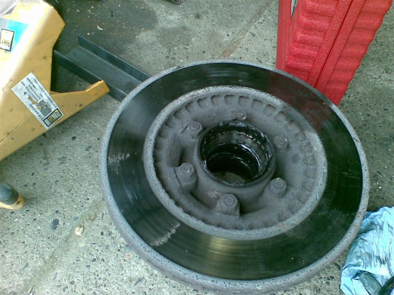

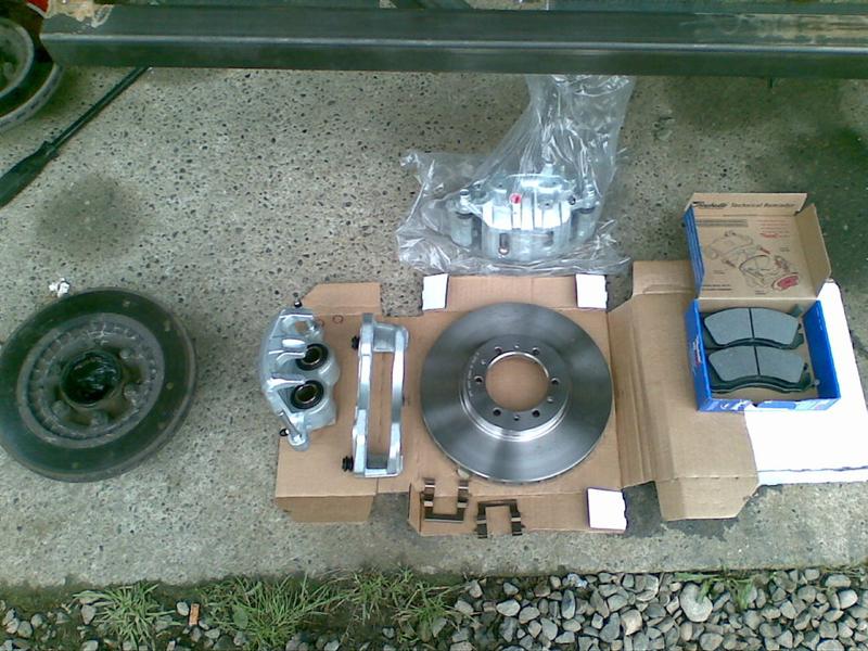

Below is an example of stock brakes gone bad. Caliper was on it's way to being seized. Because of the added heat generated, it put that smack onto the bearings. In turn, the bearings fried. Heat scores on the rotors and uneven wear on the pads are equally as good signs.
The other picture is a comparison of standard stock rotors that 99% of Pajero/Delica's come with (on the left).
On the right, you can see a Raybestos brake rotor. See the difference ?
Stock (left) has only part of the rotor face machined.
Upgraded/Raybestos (right) has then entire rotor machined.
The upgraded brakes rotors, calipers/pads will last you three times as long under the same heat/braking. There have been stats/tests done.
So, my recommendation would be to get a good, solid rotor/caliper set and don't cheap out.

I bought all the parts from the US (partsamerica.com) because I needed them asap and had to wait a few days locally through napa/wakefield.
1992 montero -
front rotors - Raybestos PG Plus 34.99 /ea (96378RGS)
pads - Raymold pads 28.99 / pair (RPD567)
calipers - Raybestos calipers 56.99 / ea (FRC10471 / FRC10472) *69 core charge semi-loaded with hardware/brackets/pins.
1988 Montero -
rear drums - had to grab locally they didn't have 'em
shoes - Pro Grade Raybestos 22.99 / pair (524PG)
cylinders - Pro Grade Raybestos 16.99 / ea (WC37708 L / WC37709 R)
Note that the 92 montero front calipers/rotors are for a GenII Pajero / L400 so you have to cut away about 1" x 2" on the shield so that the new bracket fits in place. It's simple to do with a die grinder but I was a smartass and put the hub assembly together and then figured out about the few inches I had to take off the shield. Had to use a small dremel tool which took forever. Other side was a piece of cake.
This increased the stopping power a lot. A lot meaning I noticed right away. Going from single piston GenI Montero to dual piston GenII Montero. And that was on the Pajero. I can't wait to swap out the tiny single piston's for twin's on the Delica. Being front-heavy, it should make a huge difference dissipating the heat across a larger contact area.
If you don't want to grab the parts down in the US, up here at Napa is good enough. Shop around for the best prices and take note of the core charges as well. You should be able to save a lot $ from shopping around on brakes parts.
I would not put anything on my Delica/Pajero unless it's as good or better than the professional grade Raybestos gear. There is a big difference with machining/tolerances on the rotors compared to average/no-name's and pad material wear as well. This is from 1st hand experience. You can tell just by looking at the two different make of rotors in the pics above. One will start to warp in 6-12 months and generate massive heat scores while the other will last 2-3 times as long because of the material thickness/machining.
I went over (or under) the Delica and made a note of most of the maintenance/replaceable parts. Everything I came across underneath was a direct part#/swap between a pre-1989 Montero and some upgradeable parts (beefier,etc.) post 1992-98 Montero Sport.
Meaning you don't have to import a lot of consumable/maintenance parts from Japan. A lot of what's on the Delica drivetrain can be obtained locally (made in Cnd/US) but I'm sure it's been brought up long ago in this forum.

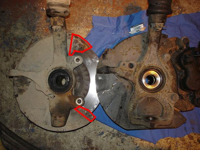

Discs were upgraded on the GenII Mitsu's (Montero/Pajero/L400) when compared to the GenI Mitsu's (Montero/Pajero/L300) :mararmeisto wrote:Thanks for the quick phone call and all the part numbers on this post jfarsang - excellent information.
Quick question to the group: anyone tried to put disc brakes on the rear? Would it be beneficial?
front/rear discs
wider axles hub to hub
larger hub assembly
larger brake/caliper's on the fronts
I may still put in the 92 montero axles. Haven't decided yet. Too many 'future' projects in my head and so little time.
If I do, then I'm sure I'll be looking at :
driveline shop to modify rear shaft flange to accept the larger dia. u-joint
welding spring perches or using the GenII coils in the rear
To be honest, I'm not sure if discs in the rear would make a difference overall.
Plus's would be less components, longevity from drums -> rotors on the rear.
As for stopping power, the largest upgrade is going from the GenI single piston Montero/Pajero/L300 to the GenII dual piston Montero/Pajero/L400.

ps. Here is the section's you have to cut off the shield to fit the new dualy's. (thanks for the orig pic Bruce)

Hey jfarsang! Did you have to do anything to the brake lines to make these fit?
Thanks!
-Mark

slider pins tend to rust on these.
Regardless of stock or the larger brake set, I would replace them with semi or fully loaded caliper that includes the caliper mounting brackets and the slider pins.
Nothing for the lines. It will depend on the calipers but some you may not reuse the L-bracket mount. Either you can bend it or fabricate a new one or don't use it at all. Makes no difference.
