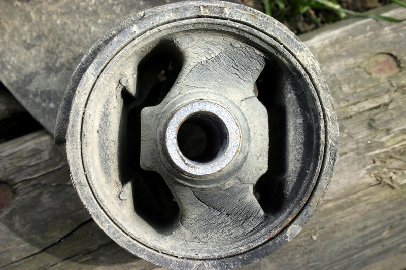

Hi all, here's a quick video starting at the turbo, then rolling back to what I think is the rubber transmission mount? Looks to me like it's torn and I'm thinking this is why I get a bit of shaking/vibration when starting off the line.....
Can anyone confirm?

Yes it is the tranny mount.
Kind of hard to see but it does look like one "arm" is starting to tear (the side closest to the tranny).

yup, and yep mine looks exactly as worn out as yours.

Thanks guys - 104 bucks from Rocky Mountain Imports.....going to swap this out soon. Sounds like its a pretty easy process - all you need is a jack.
Going to check the motor mounts too.

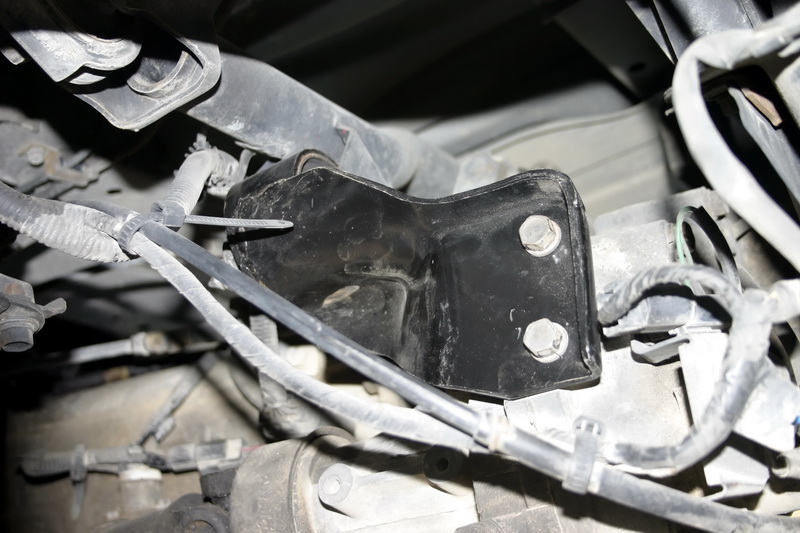

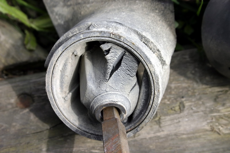

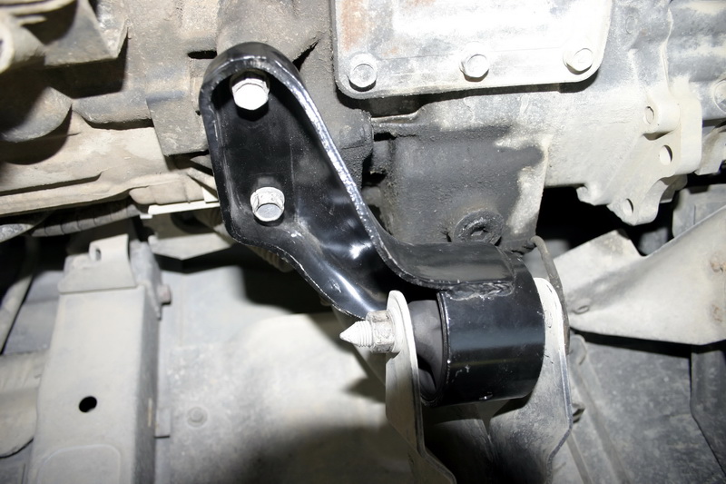

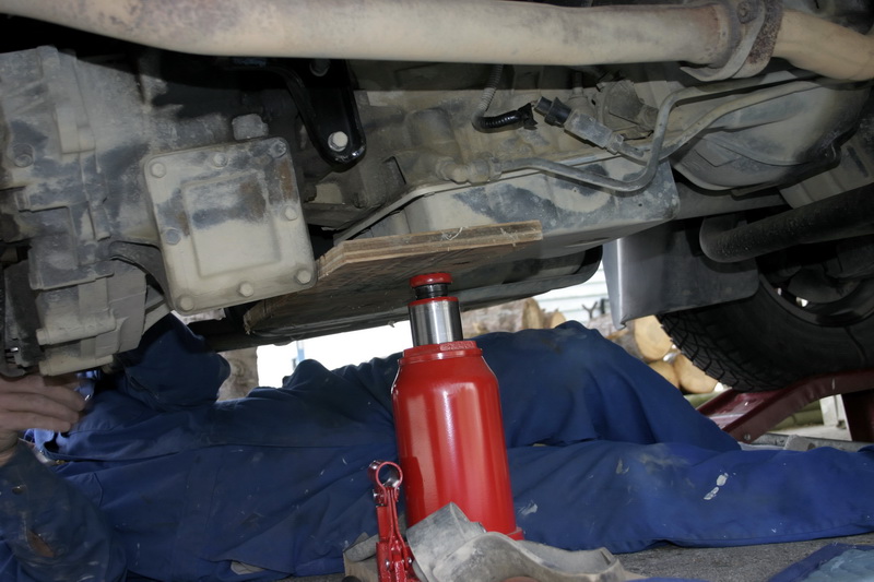

$95 a piece in MaxOverdrive and 15 minutes to replace them. Looking at the original 16-year old mounts I am wondering if this is another item that must be included in a post-import maintenance?

A bit off-topic, but where did you get those ramps? That's exactly what I need for the driveway. I used a set of stands, but that's not the same unless one is trying to get a wheel off.

Those ramps are not mine; the friend of mine bought them in Can Tire several years ago, so I am not sure if they are still available.

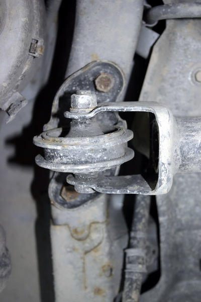

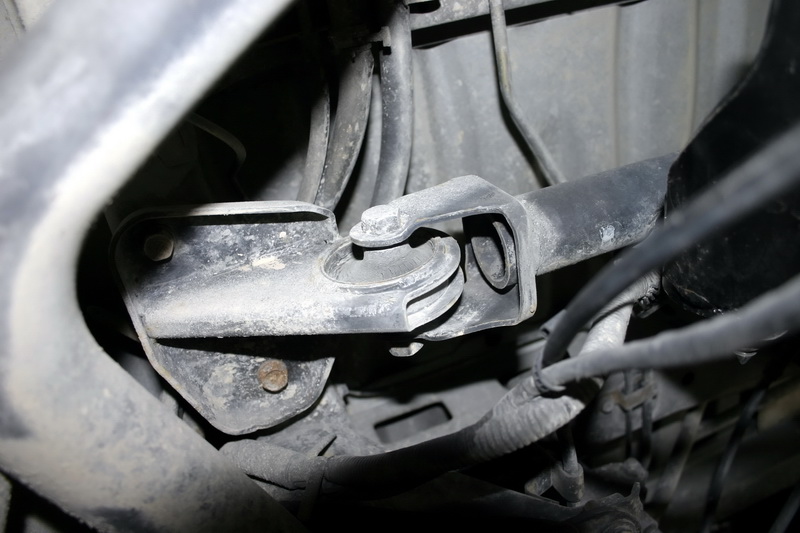

there are 2 more mounts I need to replace. They hold the bar transmission is mounted to. I am not sure what to refer to but I am providing the pictures and would appreciate the feedback.

thats also a part of transmission mount. but that one you cannot get it juts the small rubber mount . mitsubishi sells only new for about 200-250 the cost expensive.
that one is attached in the main body,
separate than the one attached in the transmission.
hope this help seegie,
