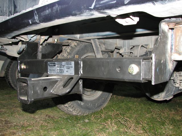

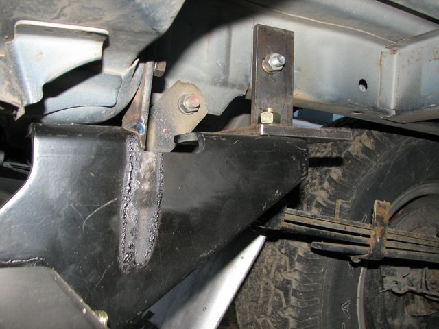

Hey folks, just thought I would share the hitch I figured out for my van. I was going to go with the $380 max. overdrive hitch, but on a whim bought the Buyer's universal class 3 hitch from Princess Auto for $80. I figured a welder could work with it for under $300. It's width is adjustable, but the challenge was to catch the bolt holes on the bumper and extend support to the frame. I found a welder on Salt Spring who helped me figure it out and welded the brackets for $120... ( a steal of a deal). It's extremely solid, probably more than I'll ever need. I had my spare off to mount this, but I'm pretty sur it wouldn't interfere.. I'm now trying to figure out mounting my WVO tank there.
I'll post pictures soon.
- IMG_8570.jpg (54.08 KiB) Viewed 5534 times
- IMG_8567.jpg (68.27 KiB) Viewed 5538 times

I would like to see a pic of it mounted from a little further back, from the images shown it looks to hang a bit low, might be a concern for off road use.

Manitoba Delica stopped by today for some WVO install talk, so I got a chance to see the hitch up close and in person. Looks pretty solid, here are some more shots:
Note the freshly installed marine fuel tank for WVO, 19 Gal, not bad. Might have to pick one up myself.
And now for the real test, how does my new CDN Tire hitch basket look on it?
Room enough to hold 12 cubes (240 litres), although I think that exceeds the 500lbs. tongue weight limit by about 50lbs.

Further on this. Princess Auto no longer has the Class III on sale, but now have the Buyer's CLass IV on sale for $119.00. I understand that the Delica can tow 1700kg and that a Class IV hitch rating is 10,000 lbs so ovbiously a Class IV is overkill. But as the price is right, would it be OK to use one anyway, or will it be too big and heavy?
In the pic's above, did the decreased departure angle resulting from installing the tank and hitch cause any problems?

Hey Folks, we just arrived home in Manitoba from our western hourney. Since the topic is on the hitch I rigged up, it does seem a bit low, but it is only slightly lower than my fuel tank, so I feel it is added protecion. It is still quite high off the ground, and the hitch rack is on, with 6 cubes of oil, it still had good clearance. I was surprised how well the vehicle handled even fully loaded with 5 people, two spare tires in the back seat, tons of stuff, 76 L of oil in the tank, and 6 cubes on the back. Of course going through some of the passes, I was going slow chugging black smoke, but it was all on veg power. It felt really good to pull through Calgary on veg power, although we couldn't connect with anyone there to get the rest of the way home on oil. A little disappointing to start paying full price again, knowing how much oil is floating around up for grabs. Anyways the hitch worked out great, the rack is sweet, and its almost good that it sits where it does, because full of cubes, you can open the back door without unloading each time.. Take care, I'll try to post pics, and stories of our trip and the WVO install....
