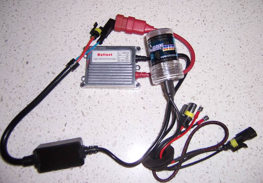

Just converted my regular headlights to HID, quite easy and amazing results.
HID Kit.jpg (81.66 KiB) Viewed 19320 times

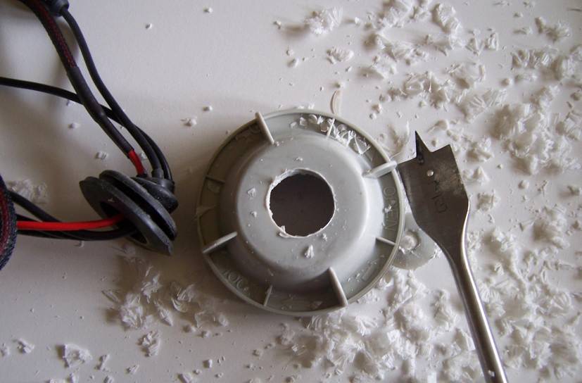

4) Drill a 7/8" or 1" hole in the center of the dust cap, clean edges
Modified dust cap.jpg (53.26 KiB) Viewed 19073 times

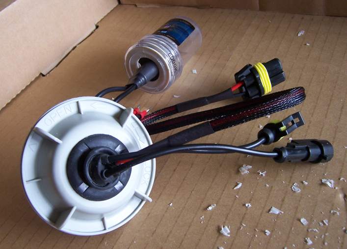

5) Insert the HID bulb assembly through the dust cap
HID & dust cap.jpg (45.29 KiB) Viewed 19125 times

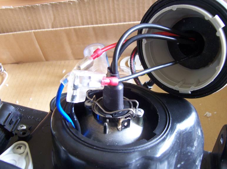

6) Remove original bulb and replace with HID, same connections so very easy
Temporary hook up.jpg (65.5 KiB) Viewed 19170 times
7) Install ballast assembly into headlight housing (use double sided tape/velcro or screw in place)
8) Reconnect all wires from ballast and main harness to headlight

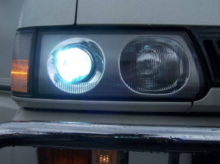

10) Turn your headlight for 10 minutes
11) Enjoy your new night vision!
Job finished.jpg (50.89 KiB) Viewed 18995 times

On a side note, I thought I read somewhere on this forum that someone had changed their lens from a E-code? to a different E-code? and noticed a brighter light from the same halogen bulbs. I'm just wondering if there are some smoked/tinted lens assemblies out there for those of us who are complaining of dim headlamps. Anybody else read this?
Re: HID Headlights, step by step
I changed the E13 for a set of Depo that I got from Mardy and the difference was very noticeable, much brighter. We compared delicas with the E13 with mine on the first meet this year (facing our lights against a wall) and mine were a lot brighter. With my HID set up it's another step up, way up in term of brightness.
But the light pattern is the same as the halogen as it's controlled by the pod shape so although it's brighter if it's aimed properly it shouldn't be that much worse for incoming traffic. It's different for sure but higher scale vehicles have them as well...
