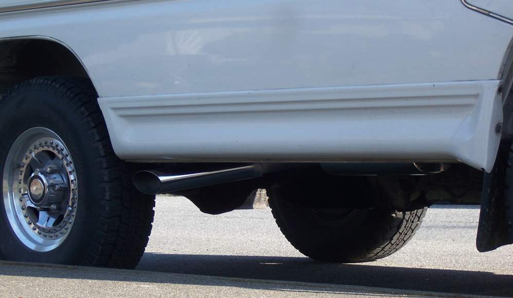

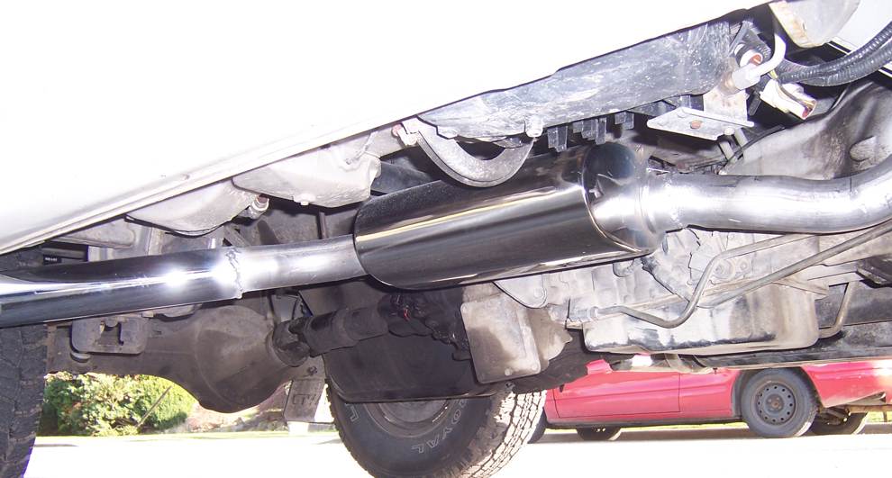

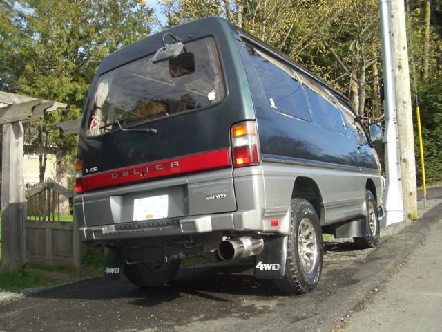

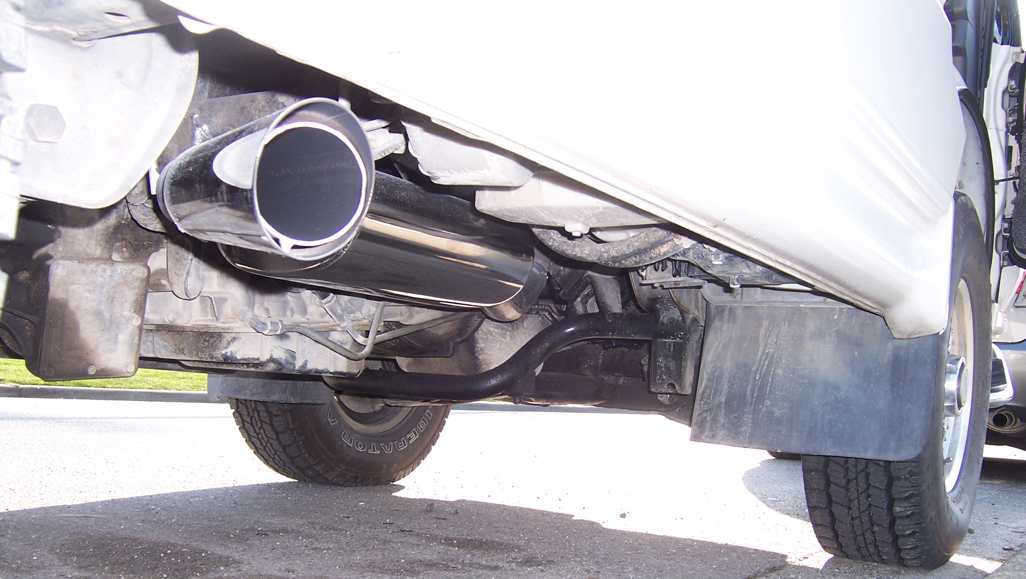

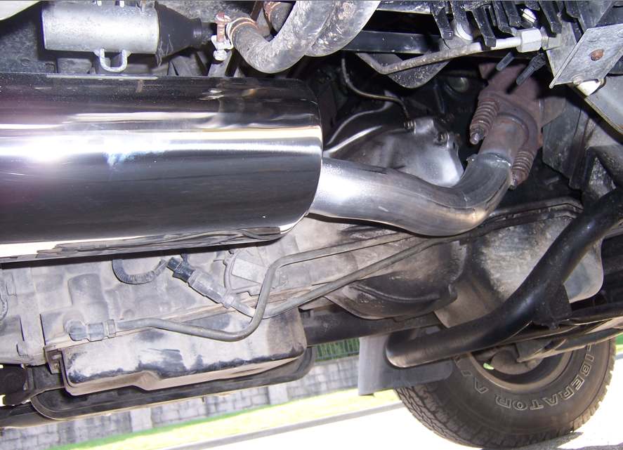

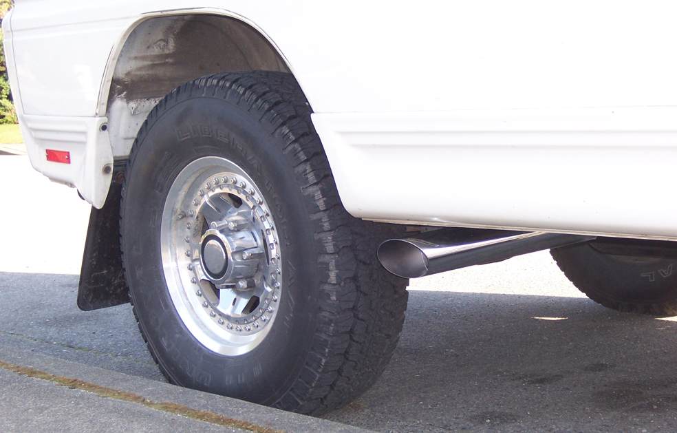

Hi all,
I just got a new side exhaust system installed on my bus and took a few pictures to show what it looks like. I did the side exhaust as I want to install a WVO tank where the old muffler used to be. It's 2 1/2" tubing with stainless exhaust can. It attached 5" down the original down pipe. I was going to use a cherry can but was afraid it would be too noisy. So instead I used a larger exhaust can and almost wish I had used the cherry can as it's barely louder than it was originally. The tail pipe looks closer to the tire than it is, it comes out about 6" in front of the rear tire. The can also looks pretty close to the rear AC hoses but I have some heat shield ready to be installed so it won't be an issue.
Here's a few pictures, as you can see it's a very short system. I've also taken a video so you can hear that it isn't really that loud. On the video I'm revving it to 3300 RPM.
I got it done at Quiet Muffler & Brake on the 7000 block of Kingsway in Burnaby. The total price came to $300 tx included. If I had gone with the cherry can it would have been approx. $235 tx incl'd. Not bad.
So if anyone needs my old and clean muffler can it's free. I'd like to recycle it if possible so PM me back. If interested I'll take pictures to show that it's clean (75000km if original on vehicle).

- Down pipe.jpg (78.1 KiB) Viewed 9255 times
- Exhaust can.jpg (75.4 KiB) Viewed 9259 times
- Full view of system.jpg (61.76 KiB) Viewed 9253 times
- Good clearance.jpg (53.07 KiB) Viewed 9252 times
- Tail pipe.jpg (62.55 KiB) Viewed 9249 times

Your set up should be fine as long as you don't care about the noise. Aircare usually requires a muffler but you're not in the GVRD so you should be fine. I have a 1yr old baby that I don't want to be death by the time he grows up so that's why I went with that set up.
Your way can always be modified if you don't like it, it's not like it's gonna cost you much! (couple feet of pipe is pretty cheap)

Too early to notice change in MPG but it does have a better feel in power. Don't expect a huge difference but it seems to flow better. I'd like to say WOW what a difference but these are no racing machines to start with... On the freeway is where I notice it more. If I'd do it again I'd use the smaller can the shop had. It would flow even better and would be $60 cheaper. I was concern with the noise at the time but mine is almost the same as the original exhaust so not a worry.
Hope this help!
