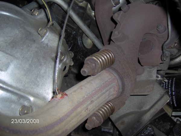

I didn't do my install, so I can't really say where it is, but crusher said he ALWAYS puts the sensor in AFTER the turbo. Cause when you drill the hole, you are bound to have some shavings get into the pipes, and you can imagine how the turbo would like that.

This is where I put mine. I just drilled and tapped the pipe for now as I'm not sure if I'm going to put a larger pipe on it or not. I put a little high temp silicone on it in hopes that it wouldn't seize in the pipe before I get some real anit-seize goop. I picked this particular spot because it is on top of the pipe where it would be protected and it is also where I could fit my drill.
In the manifold close to the hottest cylinder would be the best place to get the most accurate reading, but we're not running high performance racing machines here so I think putting the probe in the down pipe is acceptable. I have heard of guys drilling and tapping pre-turbo using a shop vac and then a magnet after to make sure you get all the little bits. But as you may already know their are not a lot of places to easily drill and tap the manifold on a Delica.

Since you installed the EGT temp sensor after the turbo remember that the temperatures can be 200-300oF cooler than pre-turbo so when you are comparing operating temps makes sure you are comparing apples to apples. I try to never let my temps get above 1000oF pre-turbo (ie 800oF post) but I think its around 1200-1300oF pre-turbo (1000-1100oF) where temps are dangerous.
If any of you are doing EGR delete mods on your vehicles an excellent place to locate the temp sensor is in the blanking plate you would make for the exhaust manifold where the egr pipe was. Then you don't have to make permanent mods to your exhaust manifold to get pre-turbo data.
