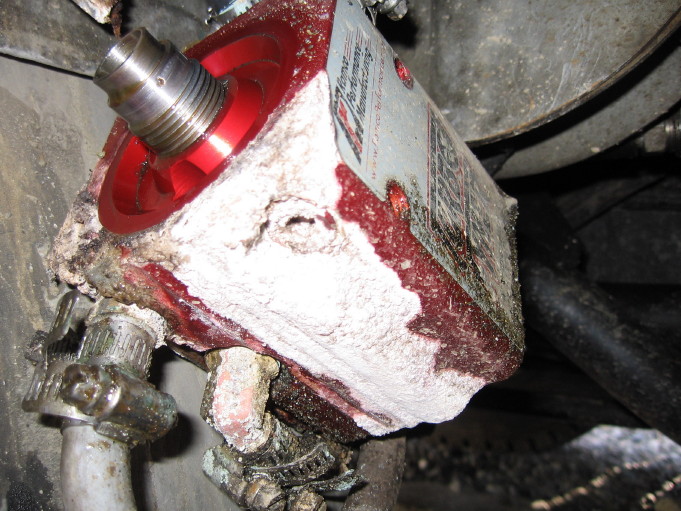

One thing I wanted to mention was when I looked at the VegMax body, it has a white hard but powdery coating running down it. What do you think that is? I have been racking my brain. If there was a coolant leak, would it react with the oil or Veg Max housing material? I will take a pic and post it. I am contemplating protecting it some how or moving it to a less exposed location.

Here is a pic of the residue on my veg max...I scraped it off somewhat but it is on there. Could either be hardened veg oil, coolant or ?? not much else is down there.

Ohh, that looks pretty ugly. It's not anything leaking from the battery is it? It doesn't look like oil to me, coolant would be my guess if it's nothing to do with the battery, but I would think to get that much residue you'd have to have a pretty serious coolant leak.

Hard to tell but honestly, I think that is from your battery. Coolant does make a white powder but usually with a green tinge to it. I also noticed my vegmax appears to leak at the weld too (extremely minor) but it looks nothing like that.
I would take a look at and around your battery, see if you see the same up top.

Looks like some sort of electrolysis like on the back of a boat if the zincs wear out. Caused by different metals in contact with each other creating a battery effect, but usually in salt water...

That is an interesting thought...I haven't had a chance to look at the battery but both are brand new and there is no other white build up in the underbody.PC Specialist wrote:
I have brass insert x mipt that came with the kit. I wonder if Plantdrive has seen this residue before. Tonight I will check the battery from the engine compartment.

So the batteries are not leaking but I noticed my coolant reservoir was low. Realizing where the over flow tube goes I would have to say that coolant ran down under the batteries, following the slope of the wheel well to the Veg Max. It must have dripped on the hot filter. Not sure the chemical reaction that is taking place with the coolant but seems to the most plausible.

Ah HA! That would answer the question about electrolysis usually needing salt water or some like fluid to occur. Wire brush it to clean it up, stop the leak and hopefully you will be ok from now on.
