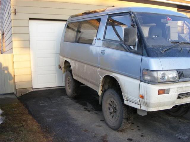

If you leave your van out over night here, the ride height increases, like they say things a bigger in Houston (or is it Texas?) It used to fit in the garage. To get it out the tires were flattened and 200 lbs of weight put in the back to give about a half inch of clearance on the door:

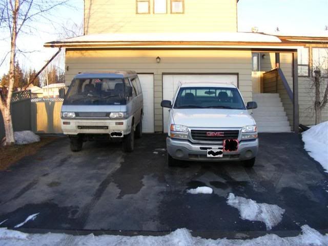

Compared to my work truck - a GMC half ton:

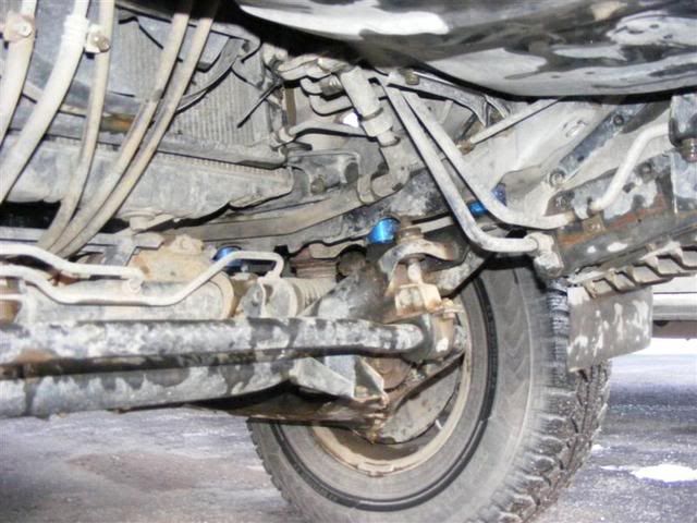

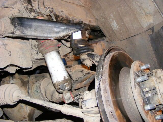

Front ball joint spacers:

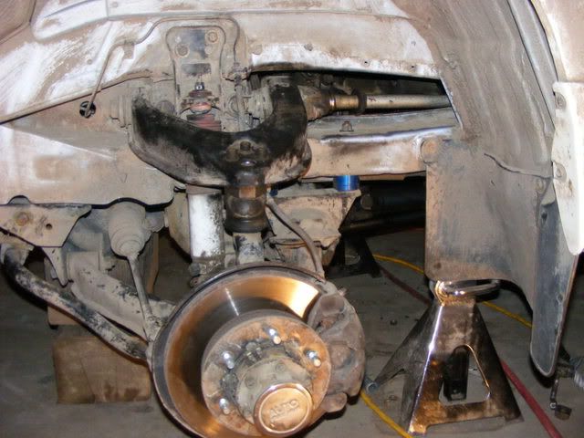

Subframe spacers, ball joints spacers, torsion bars, shocks and brake lines. The torsion bars are almost twice the diameter of the stock ones.:

I have to put the shovel on the front again, but will likely just build some better armour. Looking for wheels and tires now to complete the upsize. The ride is alot different. the better shocks and torsion bars stiffen everything up and the bouncing and leaning on corners is significantly less. This is not an easy upgrade, I figure 20 plus hours of labour now that I know what I am doing. Also, there may be a few more things crop up to adjust as I drive it more.

Wow! THAT'S what difference a supposed 3" lift makes? :shock: It does appear the rear lift is closer to 4 or 5 inches with the blocks and the shackles... hmmm.
