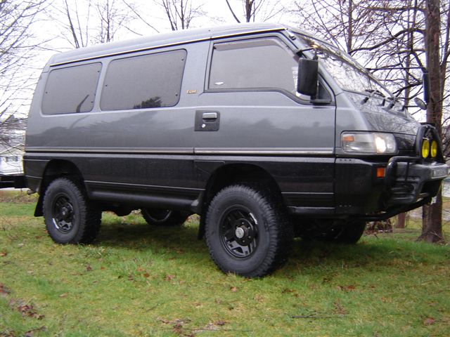

The Grey / Black Deli is Mitch's ex baby - no sure who has it now....the driving force behind my desire for 31" tires. Torsion bars cranked to virtually max up front - 2" lift in the back. Have also attached a photo of Adrocks machine too - I believe similar setup - cranking the bars and lift in the rear.
- dsc00210ey1.jpg (244.83 KiB) Viewed 7107 times

Oooops - not sure how this work...here is Mitch's machine (errr, someone elses now).
- delica 011.jpg (84.59 KiB) Viewed 7210 times
