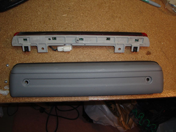

Step 1. Remove trim. It is held on with two of those plastic push-pin like fasteners. Mine broke on removal, so I used speednuts and screw to reassemble.
Step 2. Mark on the trim exactly where the lock button is. It is not in the centre!
Step 3. On the light assembly, mark the area to trim. This will make it easier to press the button.
Step 4: Unplug wiring harness and unbolt brakelight
What you now have have is:
Both trim.JPG (52 KiB) Viewed 6131 times

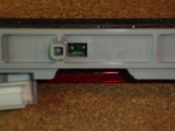

Step 5: Trim the LED assembly. I used a Dremel, but anything can work. (Obviously, my camera doesn't focus this close.)
Step 6. Put black electrical tape (or paint if you like hard work) on the back side of the LED strip, so the hole won't glow in the dark. (Although it will be below 3rd-row seat height, so not that big a deal.)

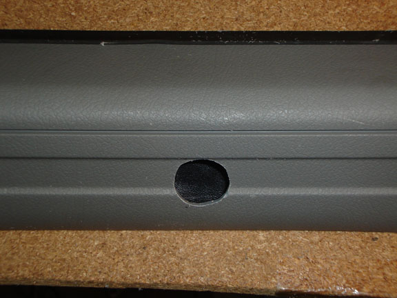

Step 7. Cut hole in trim. I made mine only just big enough to be able to lock the tailgate. If I want to be able to unlock it from inside, I'll have to make the hole bigger.
Step 8. Reassemble.

I tried using my mod today. No sweat to lock, but the hole is too small to unlock it with just fingers. I had figured that. We'll see if that's a problem. Suspect not given that if opening from outside, you use key. If thinking ahead inside, you can reach dash switch. Don't really want a larger hole. This one is about the size of a quarter.
