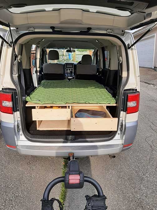

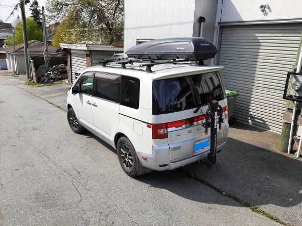

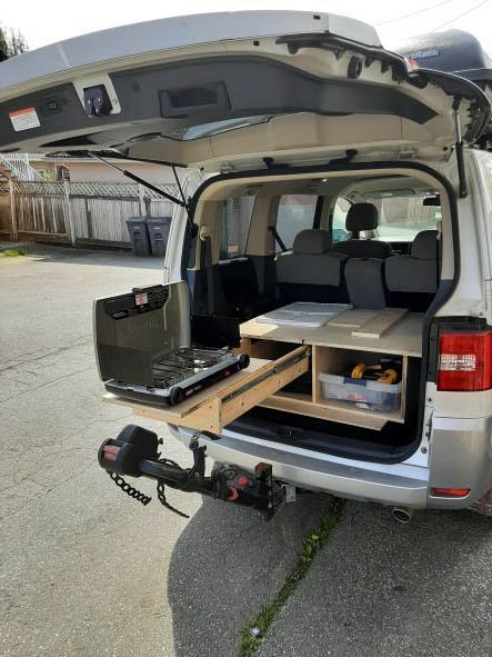

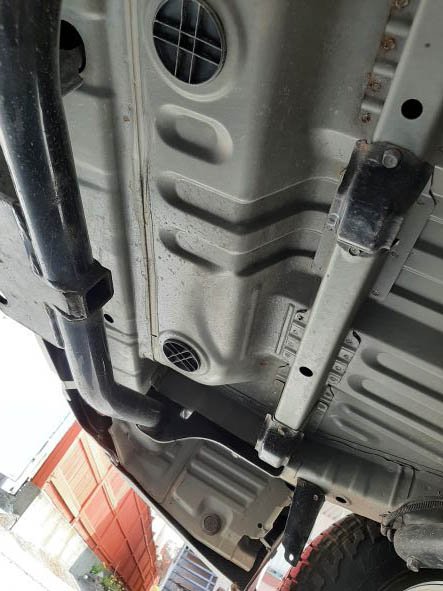

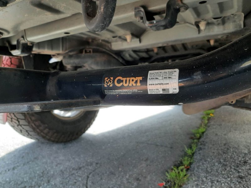

Here are a bunch of pics of my rig.
Trailer hitch is the 1-1/4 but i use a 2" adaptor for a swingout cargo carrier that turns into kitchen cabinets when parked.
Rear drawers and sleeping podium are in progress! hope to finish tomorrow.
i took out the back seats and they are for sale if anyone wants them:)

Thanks for the hitch photos.

here are the drawers and bed almost finished. Just have to trim out the drawer unit with carpet and edging, then strap it into the floor davits.
with the seats down and an ultralight mattress it is super comfy. i am 6' tall and i already took a fantastic nap all stretched out waiting for my son to come out of class one day.
only thing left is a canoe for the roof! try finding one in BC right now...
