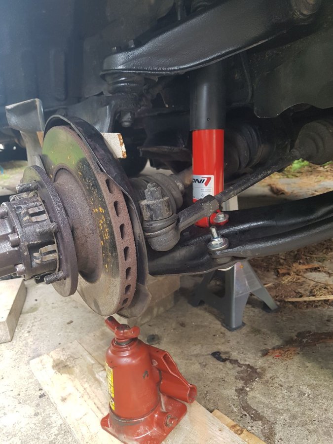

Hi all,
While doing the front shocks (replaced my OME that I could not find anymore by Kony Heavy-Track), I thought I'll do my sway bar link at the same time, bushings were near the end. The L300 is on jacks on one side (without wheel) and I struggle a bit aligning the low arm and the sway bar holes to get enough thread. Is there a special technique to do it nicely?

Hi all, I found an easy solution myself without putting back the wheel on. I used a second lift to push the lower arm up so that I could have some thread to get the link done. Fairly easy after all (putting it out was another story ... I had to use a metal saw).
I still have to tie all this clean and finish some protection painting and I'll do the other side. If I am lucky all this will be done by the week-end (may depend on temperature as the product I use for protection needs 15°C minimum).
By the way, the shocks are KONI Heavy-Track ref 30-1318 and they fit well. I still have to test how they ride.
