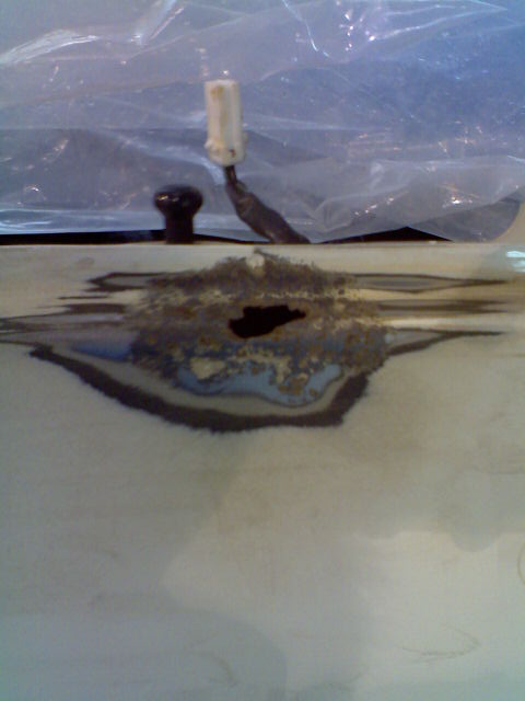

Hi Everyone,
Who else is having this same rust issue? Other than myself and Green1.
There is rust crawling out from under the rear window seal and I'm wondering if anyone knows why it does in these particular spots and what the best fix is. Remove the rear window? Will the seal survive? If not where do I get a new one? Are there other places that should be tended to while the rear window is out? It's cold on the prairies and if the back window is coming out it's not going to be for too long! :mrgreen:
Delica rust 002.jpg (20.3 KiB) Viewed 8758 times
Delica rust 001.jpg (28.26 KiB) Viewed 8757 times

Looks like more than one spot in the second pic. My guess would be to ask a window shop in the spring.
You could have them remove the window, so you could scrape and sand the rust away to base metal. Then wash with Rustmort or other phosphoric acid rust remover (see canadian tire or?) to base steel and wash with water to get rid of the rustmort.
Dry warm, fill with epoxy filler and sand to flat surface( wet 400 grit for epoxy).
Drry warm and paint with white (?) tremclad (spray or brush). Give the paint a little time to harden and reinstall the window !
Failing that, if you find more spots ask a body shop.
Small spots like that aren't hard to fill, sand and paint . You'll never know till you remove the window.
As a temp solution rub the rust off with Vim or Brasso. It may look good enough till the spring.
take care

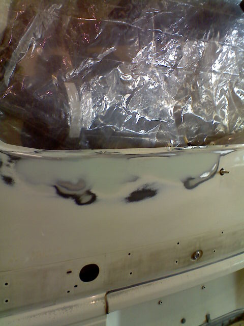

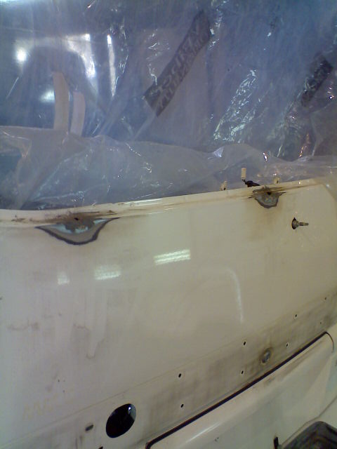

Post by Trapshooter »
rust
Trapshooter
Posts: 49
Joined: Thu Jun 21, 2007 4:32 pm
Vehicle: 1991 Super Exceed
Location: Richmond BC
Re: Rear Window Rust
after
Trapshooter
Posts: 49
when done

Excellant! Thanks for the pictures. Did you do this yourself? If so how was it to get out the back window? Was a new seal used?
Trapshooter
Posts: 49
I just remove the window for myself.....it's very easy,just use a screwdriver to push the rubber seal to push the glass out(you better with another person help you hold the glass at the other side).After you done the rush .You can use a string all around inside the gap of the rubber seal. And you will need another person to hold the glass from outside. it's better to use some soap. Then, you pull the string from inside. You can use your old rubber if it's still soft.

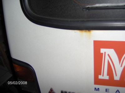

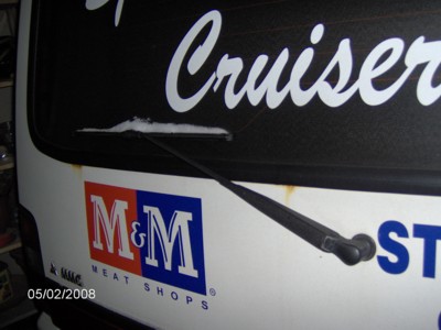

I notice that the spots line up nicely with the ends of the wiper blades. I would suspect that water flowing off the blade concentrate in those spots.
