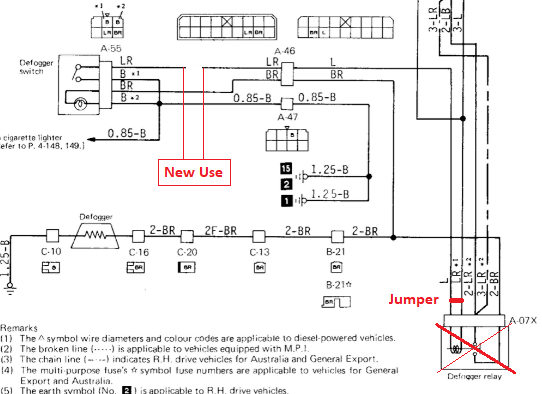

I agree. Though I would pull the relay and put a jumper (a bit of wire shoved into the correct sockets, #2 &#4 I think) to connect the circuit.
Defogger relay.PNG (41.98 KiB) Viewed 18658 times
Then break your hot wire and run that to and from your new use.
I'd also check the continuity across the two unknown terminals of the switch to see if they are switched together (the switch activates that circuit) or with the other circuits.

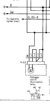

I've been sleuthing in the wiring diagrams...
It seems that the green/white wire has to do with the switch illumination.
There are two lamps in the switch. The green/white wire is energized with the the instrument panel and other dash lights when the lights are turned on by the main switch on the steering column which illuminates the defogger switch (a green lamp).
The defogger switch lamp "on" indicator lamp (an orange lamp) gets illuminated from the black/red wire from the relay when the relay is energized through the blue/red wire when the switch is turned on. (The blue/red wire is the only switched wire in the switch; the black/red and green/white are always in a state of continuity)
I think that's all correct... :)

deskinthewoods wrote: Fri Dec 04, 2020 2:14 pm
I would not worry about the extra contact - just remove it.
I'll try to have a look at mine tomorrow...

Nice drawings deskinthewoods. They are definitely easier to read than my scroll - however, you may wish to look @ the jumper you have on the switch. The connection you made puts the lights and new load in series instead of parallel. This would be a voltage divider and would not provide the 12V each needs. The light needs to be wired parallel to the New Load.

Dam - I was hoping you would make the couple little changes to your drawing to provide a clear picture of what to do. Your jumper on the relay was a great idea to make the wiring easier.
