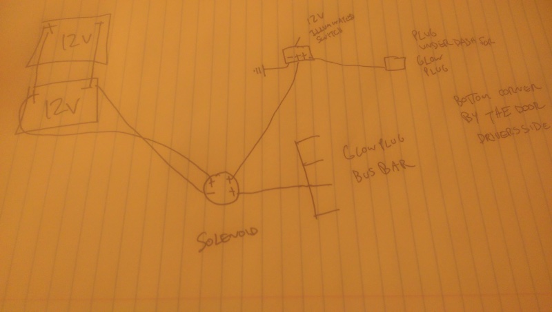

Hereis one I got from a member from here a while ago: not from me and never tried it...
Lapprentis
Lapprentis

I used the instructions I posted for the Pajero. It works well and all you need is a button some wires and a fuse for safety. The hardest part was removing the cigarette lighter so I could mount the button on the same panel. You could get the ECU repaired and hook it up while still using the button as a backup but I don't feel I need it.
