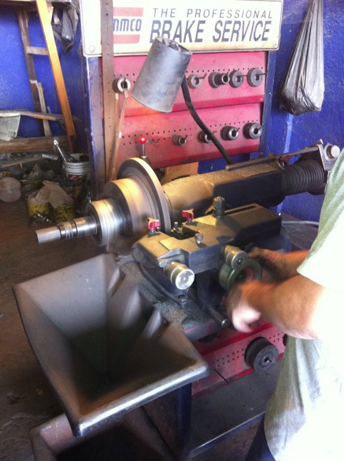

Thinner rotors warp faster. Years ago I was told delica rotors are ground by very few places because of the center hub size. A friend of Mardy refaced a front rotor for me but I buy new rotors now. love to hear your experience with this.

John Who did you find to grind your rotors?

Long story but I'll make it as short as I can. Got a quote from a Vancouver shop (CVI?) to "do" my brakes. It seemed high but he said the brakes should be good enough for my Mexico trip. Unfortunately wrong. After the beach in March 2013, I drove north through the mountains below Puerto Vallarta with little more than my parking brake (and no AC, grrrr). Found a great shop in Puerto Vallarta who turned all the rotors, replaced all the pads and fixed a stuck caliper. 3 guys working for 3 hours-total cost $220. Mexicans don't care about specs so they turned the discs until they looked good (thin), but it lasted for years.
A year and a half ago (9000kms later) had all the rotors and pads replaced, can't remember about caliper work (Rising Sun?)

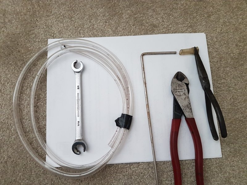

When you remove the brake line from the caliper, have a plan to contain the leak (I didn't).
The less you leak, the less you must replace by bleeding.(DOT 3 or 4)
Maybe a TyWrap and a balloon, condom, finger cut from a latex glove(?). Don't bother trying with electrical tape; doesn't work.

John See my brake kit pic w 1/4" ID vinyl hose, metal rod heated to vinyl melting temp, needle nose pliers to squeeze and seal vinyl hose. Also 3/8- 7/16 brake tubing wrench and (missing) an 8mm open end wrench for light opening and closing brake bleeds.

Heat the metal rod red and insert it in the vinyl tube (pliers side) and squeeze w needle nose pliers to seal. Slip it on the brake line ends after removal. Saves a lot of mess.
I rounded brake tubing fittings often till I used a brake bleed wrench. Make sure when you buy your caliper that it has freely moving tubing and bleed threads. 3 times I've had to tap out a "new" caliper inlet thread. Capital PITA.....

Wayne, that is a genius contraption for the brake line! My solution was far less...elegant... or effective for that matter :/

I like the idea of making brake line caps with vinyl hose. I'll try that next time.
