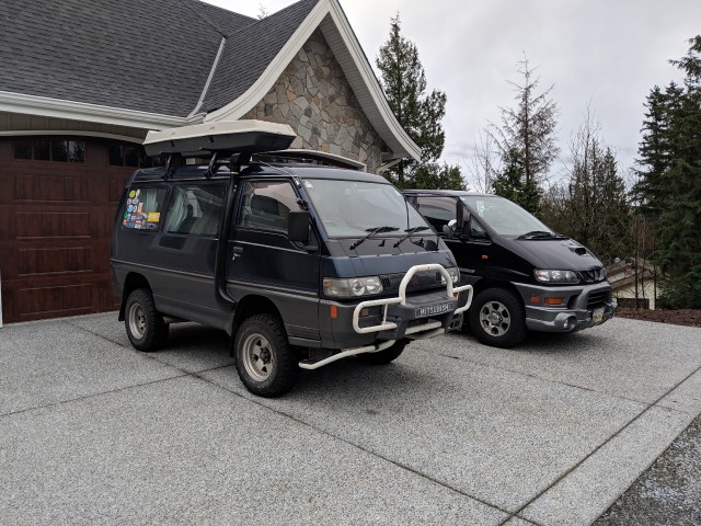

Old and new :)
Lots of work to be done and parts to swap.
I should also mention that's not my house hahahah

Nice pair! It's nice to customize a vehicle you own way. Have fun!
