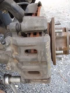

hi, i just bought a new front brae caliper for my l300 and I dont understand how to pop it open... There is a bolt on the bottom witch is easy to remve but the top bolt doesnt seems to have a nut or screw head. its a blank round cap and i wonder how to remove it as the bolt is screwed in but dont have any head to unscrew it. probably a dumb question but i looked online and didnt find any tutorial or topics concerning that issue.. thanks in advance

Im pretty sure its just a pin that slides out.
Image taken from:
http://www.delicaclub.com/viewtopic.php?t=11602

yes, the upper is a guide pin/slide... the caliper will slide off it w/ the lower bolt removed.

Indeed. Remove lower bolt, swing caliper up until it clears the brake disc, slide caliper back.
