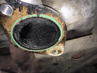

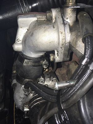

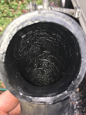

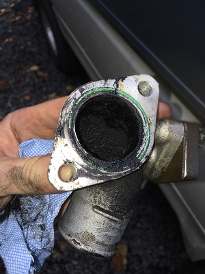

Turbo Whine
I did an oil change about 2800kms/a month ago (it's my daily driver). Semi-synth 15W40. The oil does not seem sludgie in any way, not on the dip stick at least.
Today I degreased the area as it was pretty dirty/oily. I checked the intake hoses and they are good. Tightened all hose clamps.
The turbine looks pretty good I think and turns freely, no discernible friction/resistance. Should it be able to spin for a bit after a nudge with my finger like a "fidget spinner" or just turn when I'm pushing it? Mine does not "fidget spin".
The intake hose was fairly oily inside. I take it that has to do with the blow-by pipe?
It is 9C today and after reassembly I have the same turbo whine until it warms up. Boost is still fine, hits 12PSI easily. Tomorrow is supposed to go up to 25C (October in Quebec!) so I'll be able to see if it is ambient-temperature related.

Turbo Whine
15W40 oil is fine, and the rest looks typical. You're correct: the oil in the intake hose is from the engine breather, and is normal.
The turbine should turn easily by hand, but won't continue to spin after you let go. The main thing is to look at the shaft play. The side to side play should be only about 1mm, also look for signs that the turbine has been touching the housing. (https://www.youtube.com/watch?v=ahbCMhPhjnM)
Also check for play along the shaft's axis (in-out play). There should be almost none.
Another thought: check for an exhaust leak, particularly at the flex joint where the exhaust pipe meets the cast iron dump pipe (though, again, I wouldn't expect that to go away when it gets hot).

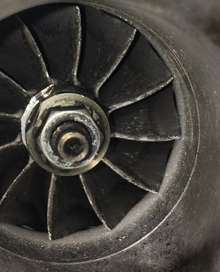

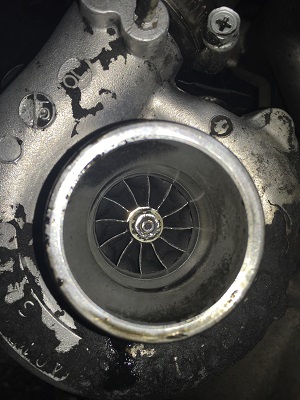

Turbo Whine

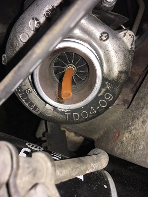

I inspected what I could this evening without removing the turbo from the van. From above and below I could see no cracks in the housing but there are places I can't see between the turbo and the engine.
Intake post-turbo is filthy, I'm sure from blow-by. I figure an oil catcher would help but is all this blow-by detrimental to the turbo?
There is less than 1mm of lateral play in the turbine and basically zero play longitudinally (in and out). I jammed a piece of tubing on the end of the shaft so I could spin it more easily and there doesn't seem to be any drag.
I can only really see the turbine by photographing it.
There is scoring along the leading edge of the fins but nothing really showing any catastrophic contact between fins and housing, though the tolerance between them is very close.
How loud is a well functioning turbo?
Would there be anything else that would whine like a turbo, when a turbo would whine, but isn't the turbo? Such as a bearing in something else that rotates only when the turbo is also rotating? (trying to think outside the box...)

Turbo Whine
That looks like damage from dust and dirt making it into the turbo, and almost certainly the source of the noise. A rebuild kit won't solve it. It won't explode immediately but the damage to the leading edge of the vanes will act as stress raisers, decreasing the time to failure.
Before driving any further you need to figure out how dirt is getting into the intake. Is your air filter faulty? Split, or incorrectly installed? Or worse: a K&N filter? (http://www.billswebspace.com/AirFilterTest.htm)

I am pretty careful about air filters, changing them every second oil change and inspecting them every oil change. When I bought the van in May of this year it looked like the air filter was beyond dirty, with a good 3/4" of sand in the bottom of the air filter "can". All to say that the vanes may have been in that state for a while.
Would the blow-by gunk have done the damage?
I will double check the air filter and all that before the trip.

Turbo Whine
Not usually, it's just oil from the engine when it reaches the turbo. After the turbo it's *hot* oil, which can turn to hard deposits (as you've seen!), but there shouldn't be any way for those deposits to get back into the intake stream.deskinthewoods wrote:Would the blow-by gunk have done the damage?
If your engine oil is abrasive, you've got bigger problems than the turbo...

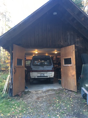

I cleaned out the garage today and can now get Wilson inside to work on in inclimate weather
First time in 15 years the right hand garage door has been opened!
