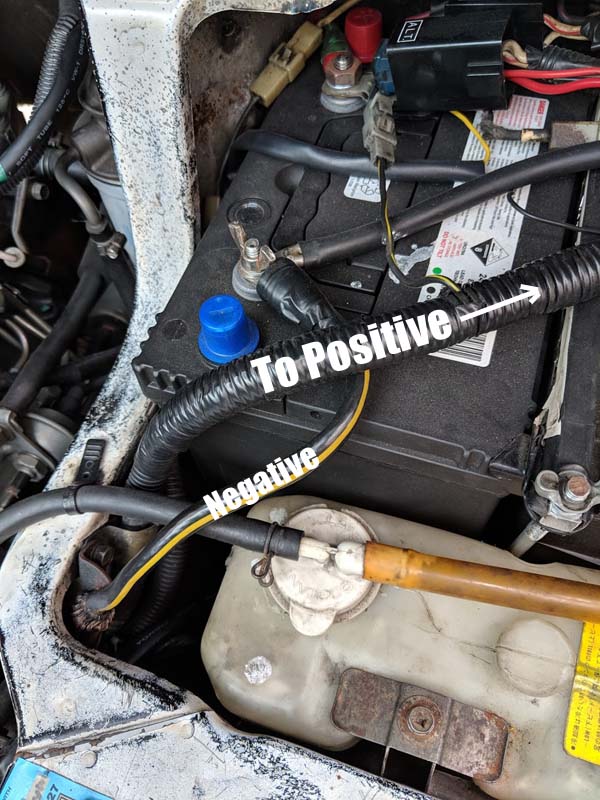

Had no luck, so thought I'd attach a pic of what I see.:
- The top shows where there is a red/black wire on the negative side.
- As far as I can tell from probing with the multimeter, all the connections in the picture provide continuity.
- Not getting any power still to the glow plug bar when ignition turned on.
Replaced batteries, lost glow plug power, and starting
Ah. The big fat cable with the ribbed tube around it? That goes to positive, not negative. It's the power feed for your starter motor (and glow plugs via that fusible link).
The only thing connected to negative should be the ground strap- on mine it's a fat black/yellow stripe cable that attaches to the body, and from there to the engine block. (It's a little misleading, because the power signal to the starter solenoid is also a black/yellow wire, albeit a thin one)

Holy crap!!! Lucky I did not melt my whole system down with that sort of idiocy connecting cables to the wrong places, imagine if I had done the opposite! (The idea to place the red tape on the leads came after I made the mistake).
I'll go check that now before it starts to snow (we have a local snowfall warning for tonight), and then post back.
Thanks again!

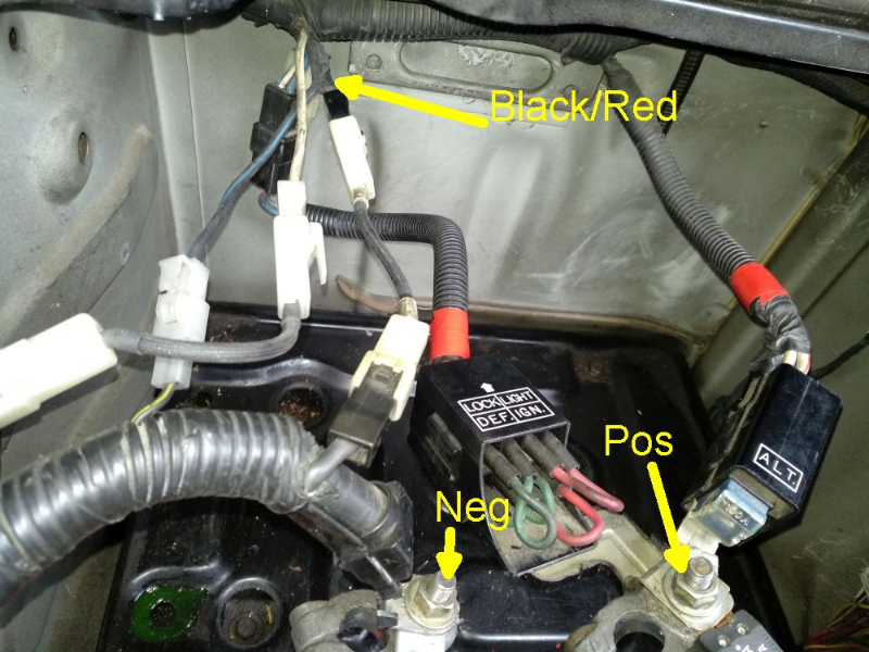

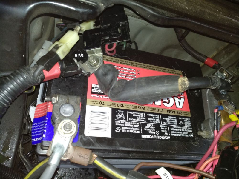

I attached the third cable to Positive side and confirmed there is +12 at that point. However, I still get no voltage at the glow plug bar or the starter. So now I guess I have to go and investigate that red/black wire again and see if I can trace it:

In the picture, it is the white/black connector that leads to the red/black wire. After I was manipulating it in order to probe through the sheath to check voltage, when I turned the ignition on, I heard the second 'click so indeed then it turned over and started. So just as you said, it would appear now to relate to an iffy spade connection. As I cannot seem to disconnect that plastic box, I suspect the problem is in that, which was activated when I was pulling hard on that cable in order to stretch it to fit the terminals.
Thanks again for all the help, without which I would not have been able to get this silly oversight corrected!
JMK wrote:it is the white/black connector that leads to the red/black wire.
Yup, the fat(ish) black wire just to the left of your new red tape, which goes to the white socket with the missing retaining tag. (And from there through the fusible link, to another white socket, to the black/red wire).
Not being able to disconnect the white sockets is usually a sign that the spades are corroded, and the heat from the poor contact has melted the plastic together. You want to clean up those spade terminals for optimum glow plug and starter operation, and for not setting your van on fire.
