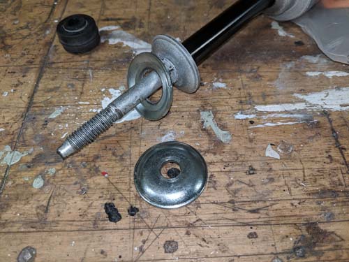

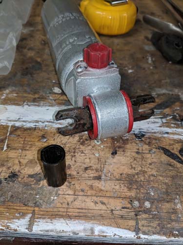

First up, you'll need to press the lower sleeve out of the polyurethane bush, and replace it with the cross pin from your old shocks. File any sharp edges off the cross pin before pressing it in, and use grease to help it go in. Silicone grease is perfect for this application.
The Rancho shocks are slightly longer (when compressed) than I'm comfortable with (more on that later), so you want to drill out the hole in the lower mounting plate/washer so it fits over the nut on the pin. This gains us another 10mm of clearance.

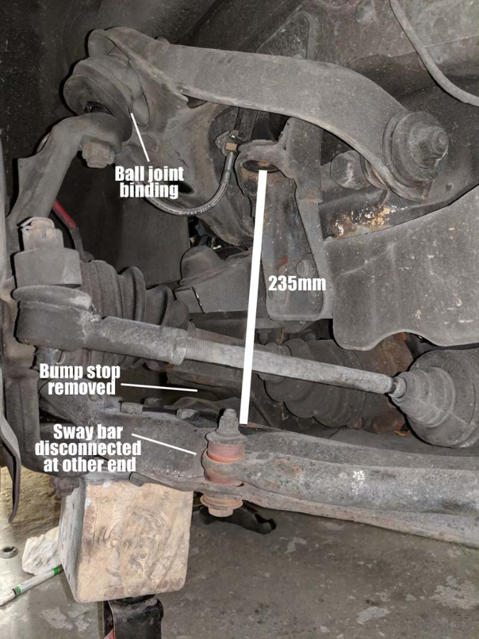

After removing the front wheels and putting the van on axle stands, I removed the torsion bar adjuster from the rear so the torsion bar wasn't under any tension, and disconnected one end of the sway bar so it wasn't restricting suspension movement either.

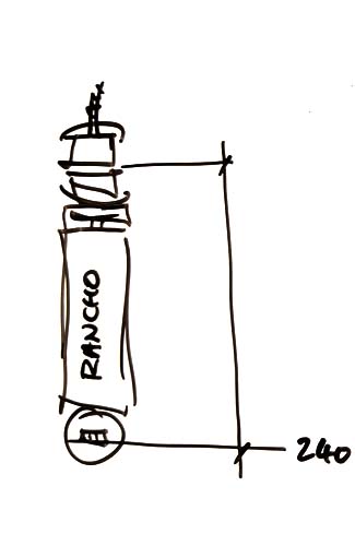

Then I removed the lower bump stop so I could see exactly how far the suspension could compress in a worst-case scenario (a split bump stop). Jacking up the suspension, I found that the suspension stops moving when the top ball joint binds, and the minimum distance from lower wishbone to lower shock mounting point was 235mm. The lower bump stop has a 2mm steel base and a 80mm bolt head welded to it (buried inside the rubber) which add up to 10mm- meaning that if the rubber were to completely fall off the bump stop, the maximum shock absorber compression would be 245mm.
The rancho shocks' minimum height (with the modified top mount)is 240mm. Excellent.
