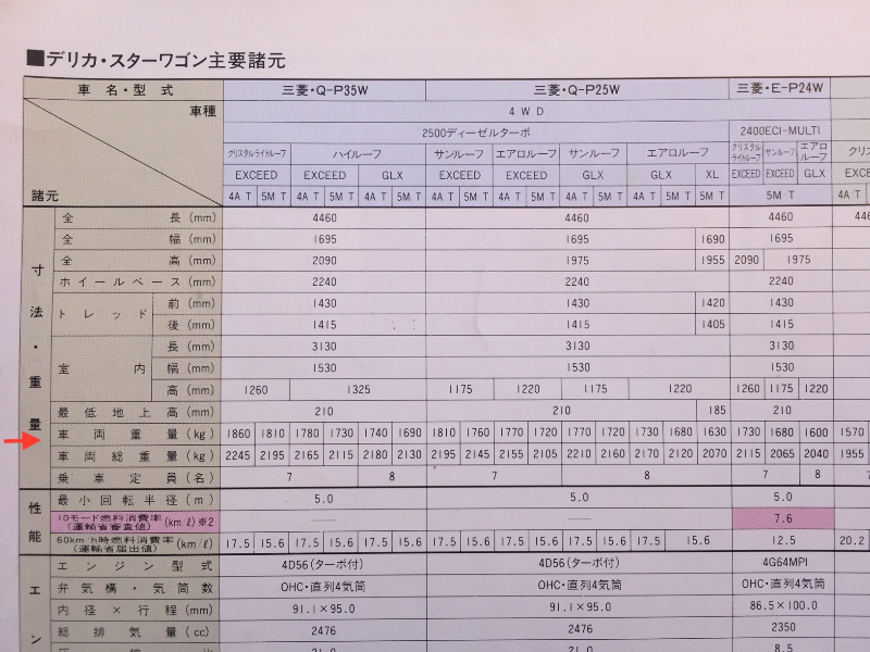

Not sure this will help you but these are from a Delica Starwagon booklet I have.
TRUSTY RUSTY
Do you have a Japanese owner's manual?
Excellent! P25W A/T sunroof Exceed 1810kg, max.2195kg, which means you can seat 7x 55kg people.
Which means, despite removing the rear seat, somehow I've added about 230kg of stuff to my van. Yikes. ...but not *entirely* surprising, I guess. Tow bar, 70l of fuel plus tank, spare Tyre carrier, 31" tyres, toolkit/recovery gear, LSD...
