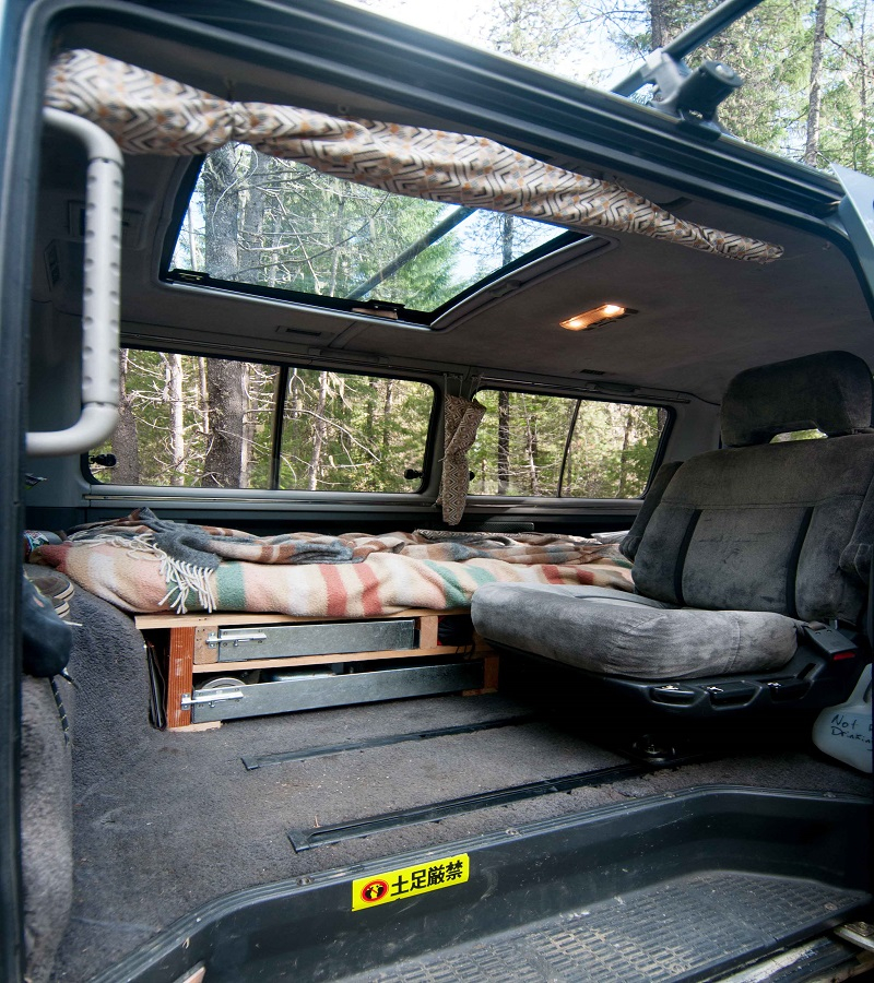

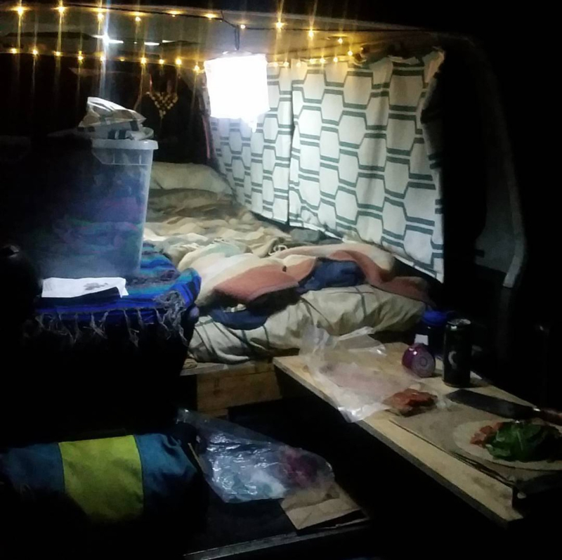

I've built mine up over the years and it has the ability to be returned back to stock.
it's not too bad. Drawers underneath and a prep/cook table that extends out the back to make mac and cheese under the huge tailgate. If I redo it I would look into the Westfalia bench seat setup, but if you can get a tent on top then that opens up a lot of room for activities in the interior!
