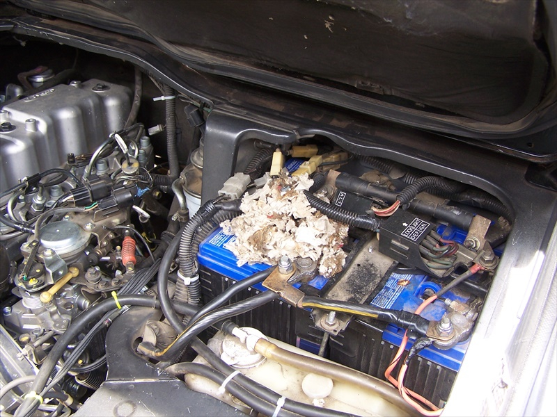

On my recent trip to Silence lake I came home to find another mouse nest on my batteries. This is @ least the third time it's happened and I'm concerned they'll do more than chew up the paper towel I use to check my oil. I've also had other occasions where I can hear them chewing somewhere under the drivers seat. A blast on my air horn usually quiets that down but that is best used when your the only one in the camp site. Has anyone else had this issue or found a simple solution?

Why Do Mice like Delicas
Is it because we store comfortable nesting material close to the warm engine and delicious wire insulation?

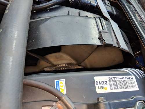

Interesting. My coolant temperature fairly plummets once I'm not hauling uphill- it certainly cools down *way* faster than it heats up. Is your engine fan and radiator shroud in place, fan around the right way (concave surface of fan blades towards the engine), and you're using the new Hyundai fan clutch? Your air/fuel ratio might be a bit rich. Above 1500rpm you shouldn't see any smoke from the exhaust, except for a brief puff if you slam your foot down. It's difficult to tune a diesel without being able to see the air/fuel ratio in real time. I fitted one of these https://www.amazon.com/Innovate-Motorsp ... B071RSKR4Z because it was about a quarter the price of a tune-up on a dyno. Plus it's kind of cool. Easy to see if it's regularly going below 18:1, and needs the fuel screw tweaked.lrp374 wrote: Once up @ that point it takes a long time to go down even on level ground. Do you think my fuel ratio could be off?
If your exhaust temperatures are a higher than they should be, the water-cooled turbo will be transferring some of that extra heat to the cooling system too, which won't be helping. Well, it'll be helping the turbo, but not your radiator.
Rodents: are they *living* in your van?! They seem to follow you around, maybe they found a nice place to hang out inside somewhere. Time for some mouse traps or poison bait?
Well, as per usual, you give me something to think about. I'm pretty sure the fan, shroud and new clutch are all in place correctly as they only fit one way. The smoke comment is interesting as I have never noticed any smoke except @ start up. There may be a slight puff but I've never noticed it. I know what smoke looks like as I also have a 5.9 cummins that can really produce smoke if floored @ low rpm. The turbo adding to the heat is interesting as I never thought of that. I know last week on the Coquihalla the EGT was almost 1200 F and the water near max in 2nd gear with 3000 rpm. I think the grade was only about 6% most of the time. It was only 25 C. I've done that previously @ 40 C with my old engine. ( No A/C on for either case.) I think I need more info and your suggestion of the air/fuel ratio instrument could likely provide it. Where did you mount the sensor? In the meantime a fuel adjustment may be in order. I haven't done it before so will need to read up on it a bit and find the screw. The one thing I keep coming back to is my recored radiator. The shop I took it to does all kinds to recores so I would think they know what they are doing. They said my old rad basically disintegrated when they started to acid wash it. When I installed the new rad it made little or no difference. At that time I thought my problem may be somewhere else. Now I'm not sure. Thanks for your help so far.
The mouse is definitely not living in the van! The first mouse was 150 km north of Kamloops and the second was 150 km south. For the time it is @ home I've never had a mouse. I've had a few camp problems over the years but never 2 in a row. My solution for now is no more paper towel to check oil level. Hopefully that will help.

I had mice problems (is roommates the correct word here??) In my last van, an 87 4wd Toyota from the states. Here's my 2¢:
If you are living in the van (I was living in my van for ~4 years), guarantee some crumbs or leftovers somewhere have attracted the buggers and they have somehow marked the secret way to access your home. I used to wake up to them climbing the leaf springs directly below my head! Always the same sound, different campsites throughout NA... Then I could hear them next running around inside and below the bed! Sometimes they were in the head liner. I didn't want to go with poison for fear of them dying (then roasting and stinking) in the headliner. Waking up to a snap style trap is also a terrible way to start your day...
I bought a live mousetrap, little rectangular metal box that traps mice. I was able to extract probably 10 mice in 4 years with this trick. I also put peppermint oil on cotton swabs near where they entered, that seemed to help for a while. For your battery area, maybe spray some of that around the insulation?

Thanks for the idea chonchito. I'll try the peppermint spray as I only get mice when camping and they only build nests on the batteries. Now all I need to do is find some!

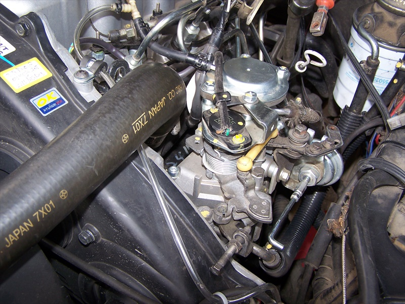

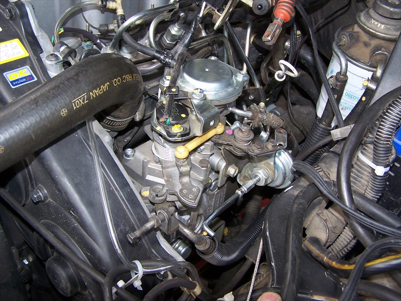

Well Growler I've started to change the settings as per your info for new Hyundai engines and have got the fuel and boost compensation done which I thought would be the difficult part. However, I need your definition of a nubbin to continue. I presume it is the yellowish plastic piece that joins the accelerator and transmission cable thingys. I haven't removed it yet as I think something else is quite different than yours. I set the idle as you suggested and there is no way I can see it ever touching the idle stop. I've taken a few pictures which hopefully will mean something to you. After completing the first 2 items I marvel @ your picture taking as with my hand in there I have no room for a camera. Great job!

I think I may be getting in a little over my head here so I thought I'd ask the expert before I do some damage!. Without changing the accelerator stuff I thought I'd start the van to make sure it would run. It did but only an idle with full throttle. I don't understand how the changes I've made so far did this. I feel it must be the boost compensation as changing the fuel should do nothing when sitting still. I put the diaphragm in like shown in the photo and also put it back the way it came out. It was better with the front position. Was I supposed to put the plastic collar back in?
Could you please confirm which nut to loosen and rotate for the accelerator. It may be a dumb question but it certainly isn't the first I've asked and I'm sure it won't be the last!!
