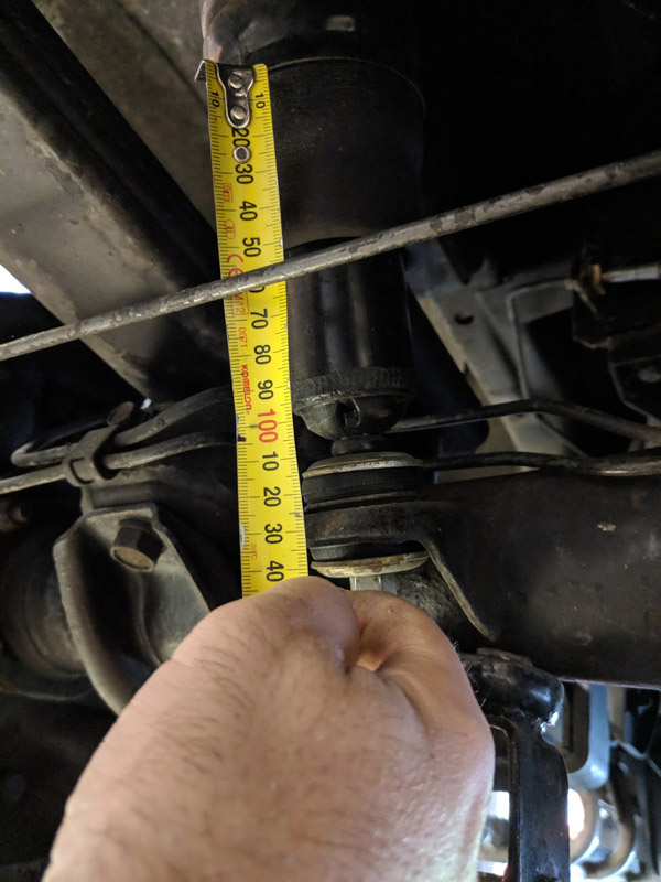

I just put new Rancho RS9000 on the front of my 91 Delica l300 and now hear a clunk on certain bumps, but not all. It's doesn't matter if I adjust to the hardest setting. The Rancho's do have less compressed travel but more extended travel than stock (about 30mm longer compressed than stock).
I'm assuming I need to add taller lower bump stops? Sounds like I'm bottoming out the shocks before they get a chance to reach the bump stops. Can anyone confirm?
If I raise my front end (by cranking or reindexing torsion bars) will the extended travel these shocks have be utilized or are we limited by the upper/lower controls arms being a set distance apart?

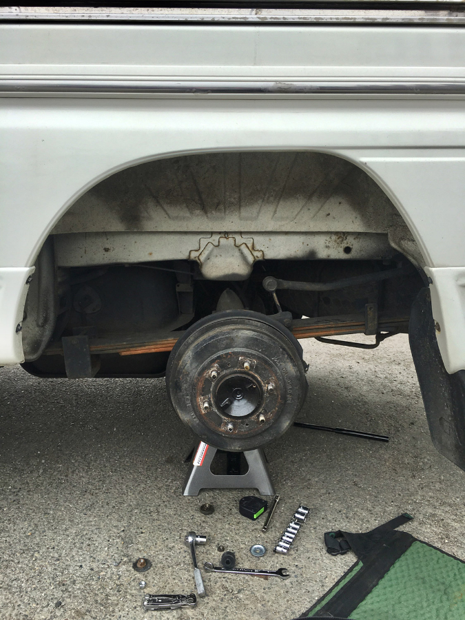

I also have new rear Ranchos but when I went to install the compressed length just barely fit (about 30mm longer compressed length than stock) so I decided to keep the stockers on for now. I noticed my leaf springs were pretty much flat so I'm also assuming these need to be re-arched in order to lift the rear and have the new shocks fit properly?
Rear height from center of hub to top of wheel arch is around 49cm.
thanks for any insight. I looked around the forums of course but nothing specific to this that I could find.

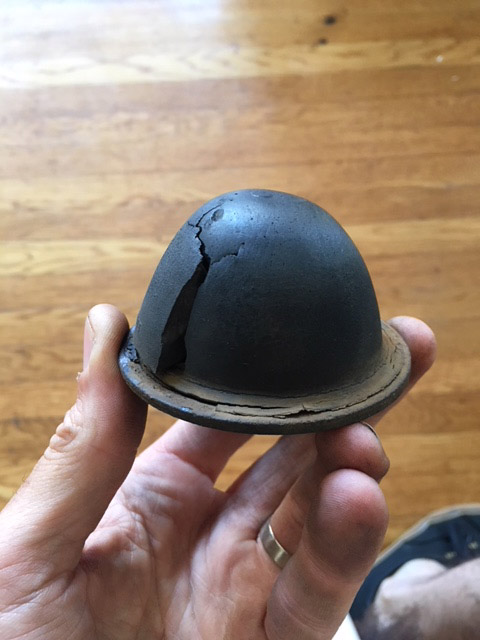

Just took my front lower bump stop off the drivers side (to see if the auto parts store has any a bit taller) and it's cracked anyways so probably need new ones no matter. Also looked at my shocks again and sitting on relatively flat ground there's no a ton of compressed travel left. I want to raise the front end by cranking the torsion bars but the fact my rear is at 49cm as well as my front currently I don't want the fronts taller.

You definitely don't want the front shocks bottoming out- the Ranchos don't have any internal bump stops and can be damaged. Hopefully that rubber bump stop is the culprit- you'll replace both sides, right?

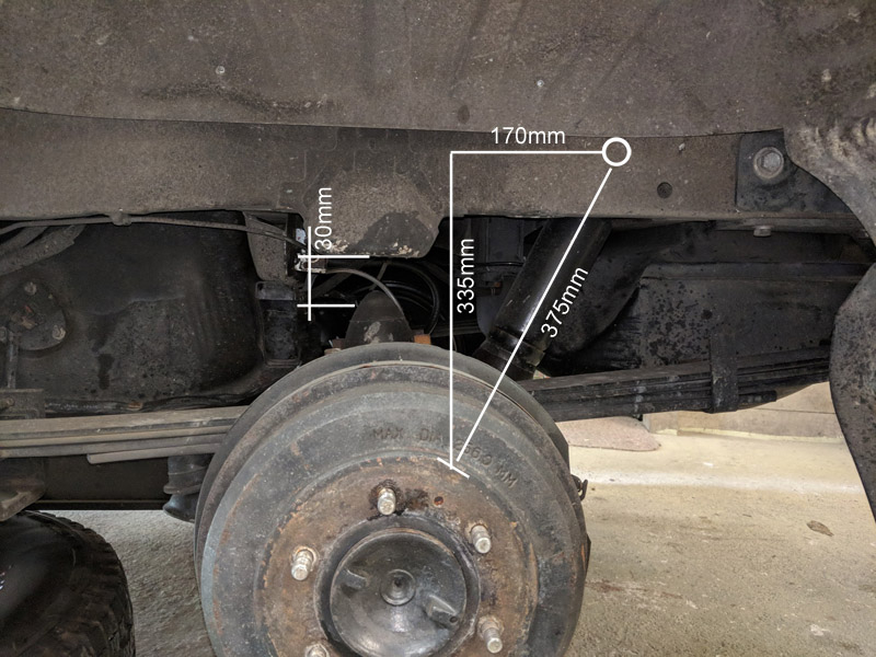

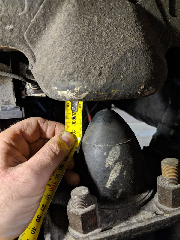

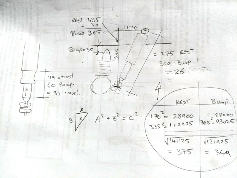

The problem you're trying to solve is "what happens when the rear axle hits a big bump". The axle gets pushed up until the bump stops contact the chassis and arrest the upwards motion. The shocks need to be short enough to allow this to happen. If the shocks are too long, the bump stops won't hit the chassis, and the shocks will take all the load.
Lifting the van won't change that. The bump stops are still the same height, and the axle can still move upwards far enough for the bump stops to hit the chassis. (It'll take a bigger bump to do it, sure, but it's still possible).
You need to measure some things and do the math to figure out if your shocks are short enough.
Here's my van's measurements with the Monroe air shocks entirely deflated: I estimated that the axle can move upwards by 30mm by measuring from the chassis rail to the clean, worn line on the bump stops, which is created when they deform from hitting the chassis rail. The actual measurement was closer to 25mm but I added 5mm for luck. I measured the length of the shock at rest between the lower edge of the dust shield, and the weld on the lower part. At rest this measurement was 95mm. I undid the lower mounting nut and, using a crowbar for leverage, pushed the shock closed as far as it would go (not pictured). The measurement reduced to 60mm. 95mm - 60mm = 35mm of upwards movement possible. So, from rest the axle can move upwards 30mm before the bump stop limits the movement. My shock absorber can move 35mm, which suggests that the shocks have 5mm more travel than I need. Pretty close, but still ok.
But wait, it gets better because the shocks are at an angle. 30mm of upwards movement at the axle doesn't mean they get 30mm shorter. 3rd grade geometry to the rescue: When the axle moves 30mm upwards, the shocks get 26mm shorter. The shocks have 35mm travel between rest and their bump limit, which means I have not 5 but 9mm more travel than I need. Awesome.
9mm would normally be a bit close for comfort- the bump stops could easily deform 9mm further than usual under an extreme load. Fortunately the Monroe shocks have an internal bump stop, so even if they reach the limit of their travel they shouldn't be damaged.

Wow thanks for going to such great lengths Growlerbearnz! This helps a lot to understand what I need to do to measure how much compressed length I need (until the bump stops make contact) vs what my shocks will give me. It's a bummer the Ranchos don't have internal bump stops, wish I would have known (or thought to look) before purchasing.
