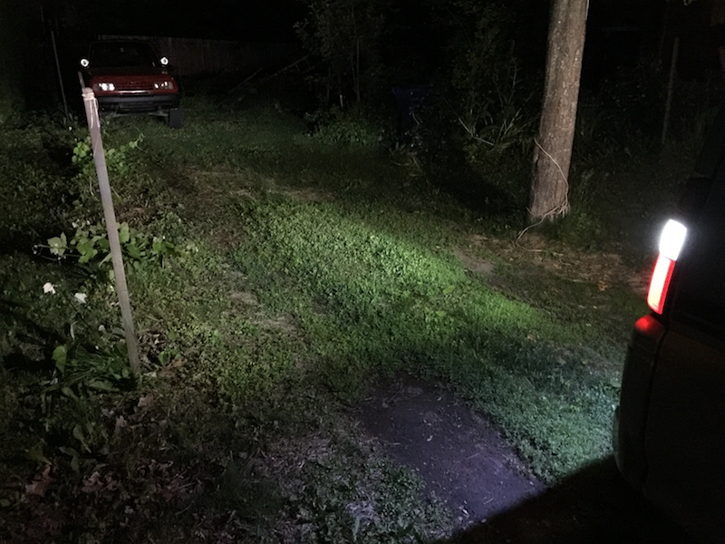

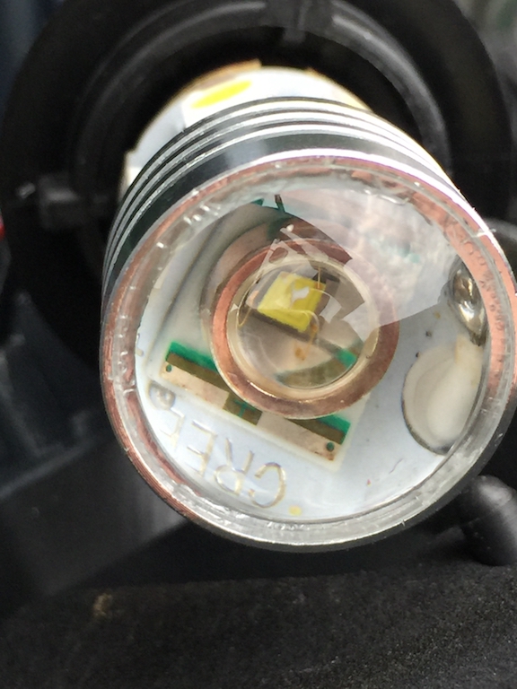

Here it is, a CREE Led Light bought on Ebay a while ago...sorry, not part number on it...One is with reverse light on (the Suzuki is 10M away) and the other on without it
Now, if you have tinted glass....you may need something more powerfull
