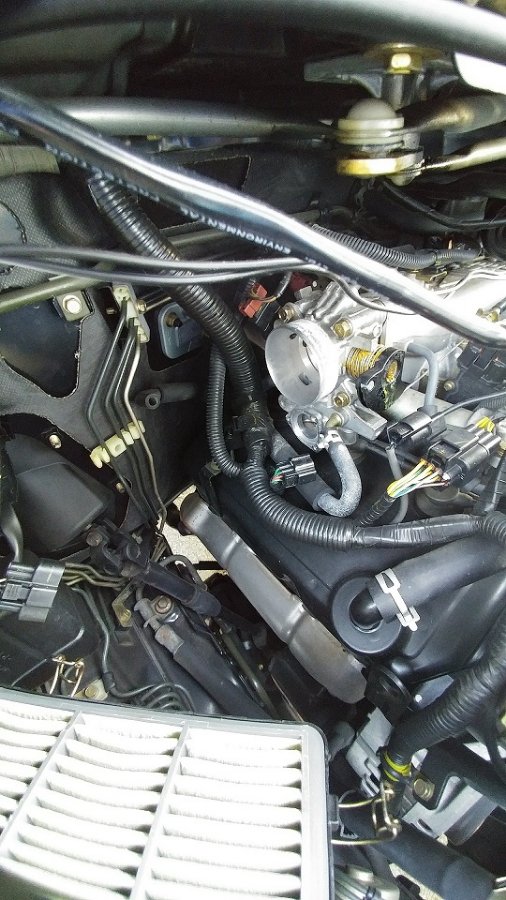

Let's just say the plugs are beyond my DIY comfort level for now lol.. Case in point, after cleaning the IAC and throttle body, I now have a misfire AND slightly erratic idle lol... In any case, for various reasons time is of the essence, and if the new coil doesn't solve the problem I'll have to tow the van to CVI to have a look
Here's a couple videos so y'all have an idea what it looks like
before cleaning
https://photos.app.goo.gl/dEmzhYGDvT6P03DB2
after cleaning
https://photos.app.goo.gl/XZGQEgOw6B6M4g5v1
cleaned those two holes with disposable shop towels

- 20180318_183841.jpg (471.25 KiB) Viewed 26193 times

it sounds like you're on the right track. An observation that's probably not related to your current misfire issue: 30,000km is super low for a 15 year old vehicle, only 2000km a year! I'm hoping it had a full service when it was imported, but if not I would be changing all the fluids. Engine oil, transmission fluid, transfer case and differential oils, brake fluid (definitely brake fluid!) and coolant. Low mileage is good for the metal bits, but not so good for rubber seals and fluids.
Anyway, let us know how you go.

I'd expect the engine compartment to look like that w 30K Kms. How was it rated at the auctions?
Is it really that clean throughout the entire van? Does it have a new van smell? Mine was at 32k kms.
I'm not asking to criticise but to complement you on an awesome purchase. You should be very happy with your van.... but...... expect a few problems. If you're rich I'd take it to CCA on Van island and give them a free hand. You'll never look back. Otherwise buy some tools there's lots to do. Do you have a garage?
I have more ideas about your idle problem. Looks like you're in the lower mainland so if you want to talk PM me and we can exchange ph numbers. I'm retired and have lots of time till fishing season starts in a month.
