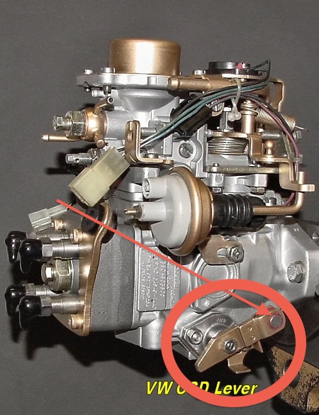

Hello everyone, I'm hoping to accomplish a modification to a 2.5l injection pump that will allow for easier cold weather starting. The idea is to have a cable leading to the cab to activate the diesel equivalent of the gas engine choke.
Adding a mechanism to the injector pump that advances the timing of fuel injection ~5 degrees, thereby allowing more time for fuel to burn, involves one of two common methods (that I know of);
1) Levered cam acting on the roller ring directly,
2) Levered screw acting on the timing piston to advance the roller.
Anyone done a retrofit using the second method? Perhaps there is a l300/l400 4d56 pump that includes such a thing already (in which case I'd love the pump number). So far in my search, tho, it looks like there was no advance mechanism on the Astron diesels using the timing pistion.
My preference would be to use the second method as is done on older mkII VW diesels because of its mechanical simplicity and apparent robustness. The 4m40 units came equipped with pumps using the first method as did the 4d55 and many other pumps including my old Mazda diesel, and I have a suspicion that it will be challenging to achieve the proper spring pressures on the timing piston using the VW equipment. Perhaps not. May be this system is prone to leaking, and I'm not sure how hard it will be to find the parts that will alow for the retrofit like the piston and screw/timer caps but may be its as easy as swapping parts from a VW bosch pump, which someone here suggests is being done.
The first method involves machining the existing mount cut-out in the pump body to allow the ball on the cam to act on the roller (or just getting an American 4d55 pump body and swapping internals, if that's even necessary). This method shouldn't interfere with timing, but I hear of these breaking and doing damage to the pump internals. May be my fears are unfounded.

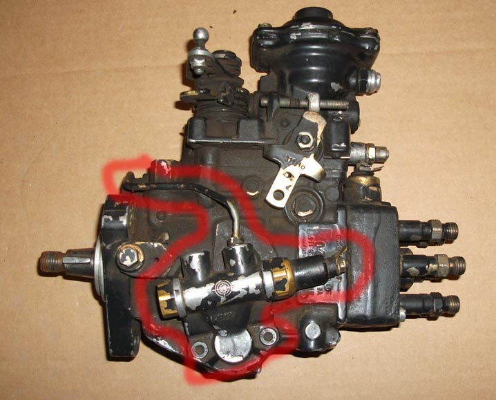

I'd forgotten about the third, hydraulic, option. This is what the isuzu, cummins, Volvo, and many other automated ve pump automated cold-start mechanisms use. It advances the timing by temporarily increasing pump body pressures to hydraulically advance the timing piston that way it would under normal acceleration.
I'm not interested in that clap-trap!
A disadvantage or two: It will not be immediate that is it requires the engine to crank and build up pressure before it does the advancing which is why the curve of the advance vs temperature graph shows the arc starting at 0 (how long does that take?). Also, the pressure regulator valve then becomes complicated. and so does the temperature automated thing a ma doodle wax solenoid.

A Isuzu pup solution to leaking was to get rid of the hydraulic advance mechanism and put in the VW/bosch screw sort.
http://www.isuzupup.com/viewtopic.php?t=7773
Frank's Finished Pump for Printing w cap.jpg (105.75 KiB) Viewed 9229 times
This option should not require drilling the pump body or replacing the roller ring.
Growlerbearnz wrote:bolt-on mod, and easily reversed if needed.
My number two, pictured, won't be so easily reversed, since it requires replacing internals. I can't find a zexel 20mm pump that has this type. I pick up a VW mkII bosch pump this week and will see what I can make of it and will share what I find.

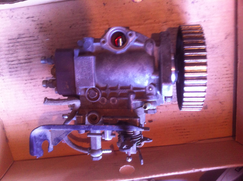

Well, didn't the source pump I acquired come devoid of the advance lever/timer cover I need to do this! At least I got the timing piston and cable mounting plated. I'm hoping to share the difference in my cold starts before/after, that is, before the cold weather lifts entirely. We'll start to see more Delica's posted for sale once the temps climb up, won't we :)

Looks like Pump MD307497 is shown here to include the cold start advance mechanism that acts on the roller ring using coolant to control a wax motor. So it looks like this pump came on the Jasper and or Chamonix editions.
Another option would be to acquire one of these pumps.
