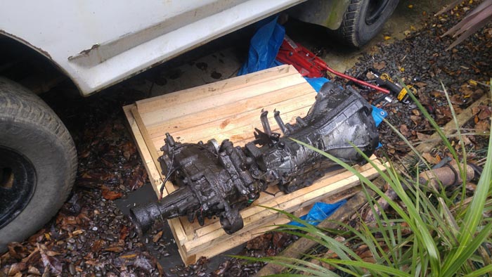

Progress continues. The Automatic and Manual bodyshells are identical*, so far there's been no drama in swapping the parts. There's even a hole in the floor for the clutch line bulkhead fitting, and a tag on the frame near the bellhousing for the clutch flex line to attach to. Witness the new bulkhead fitting (and the shameful collection of fluff and junk that lives under the carpet:)
My new gearbox is in pretty good condition, considering it's done 360,000km. The mainshaft retaining nut that holds 5th gear in place was only slightly loose, the staked section had stopped it coming undone (which would have wrecked the gearbox). I'll be using loctite when reassembling.
All gearbox bearings, seals, and synchros are still available, so I've ordered them all (might as well, since it's pulled apart). Selector forks are NLA which is a bit disappointing, since the forks are a bit worn.

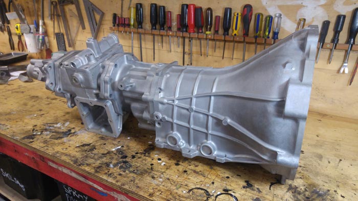

So. What to do while waiting for parts to arrive from Japan? Clean and bead blast the gearbox cases:
Mmm pretty.

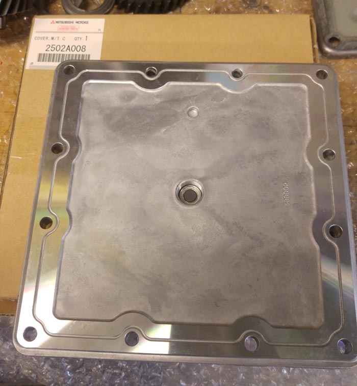

The first thing is that the gearbox case can flex under load, which allows the countershaft to move away from the mainshaft, changing how the gear teeth mesh right when they're trying to handle a lot of power. It's not a huge deal, most L300s don't have enough power for this to be a problem, but I'm covering it first because I have the solution right here:
A cast aluminium lower cover, which replaces the pressed steel cover. Fitted to the Mitsubishi Starion for only two years (1988-89) with original part number MD727553, no longer available, and rare as hell. Starion and 4WD guys have been making their own versions out of alloy plate at enormous expense. (http://projectzerog.com/forum/viewtopic ... 6c461631ff , http://www.starquestclub.com/forum/inde ... pic=100703.
...except... they're not rare or unavailable. Mitsubishi put them back into production in 2000, albeit with a different part number.
Part 2502A008. CAD$52. You'll also need the O-ring seal MD727531, CAD$17. Definitely fits a V5M21, should also fit a KM145.

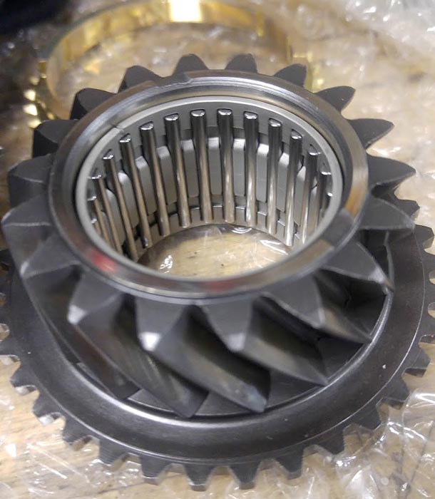

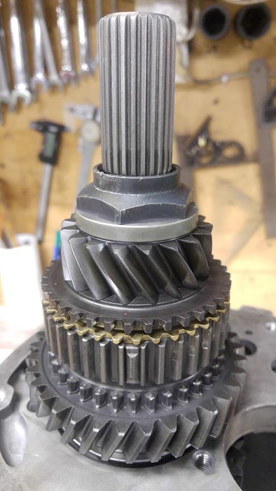

5th gear failure modes:
KM145 gearboxes (up until about 1990) had a very weak 5th gear. Because the gearbox was originally designed as a 4-speed, Mitsubishi had to make the 5th gear very small to get the desired overdrive ratio, but that didn't leave much metal to hold the gear together. Older 5th gears just broke like this:
When they revised the gearbox (changing the name to the V5M21) they increased the countershaft gear ratio to enable a larger 5th gear to be used, while reducing all the other gear ratios to keep the overall ratios the same as previous gearboxes. The 5th gear no longer split as often, but now there was another problem: the 5th gear bearing sleeve comes loose. The gearbox I'm currently rebuilding has come loose, but I've caught it just in time to be repairable.

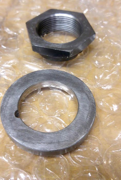

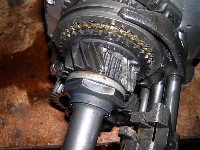

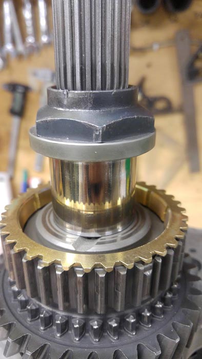

If you remove the transfer case and look inside the gearbox extension casing you'll see the retaining nut holding the thrust washer, keeping the 5th gear and bronze synchro ring against the shifter hub.:
Inside the 5th gear are caged needle rollers. These let the 5th gear spin freely when it's not being used.

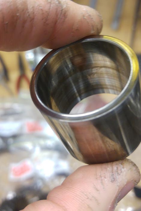

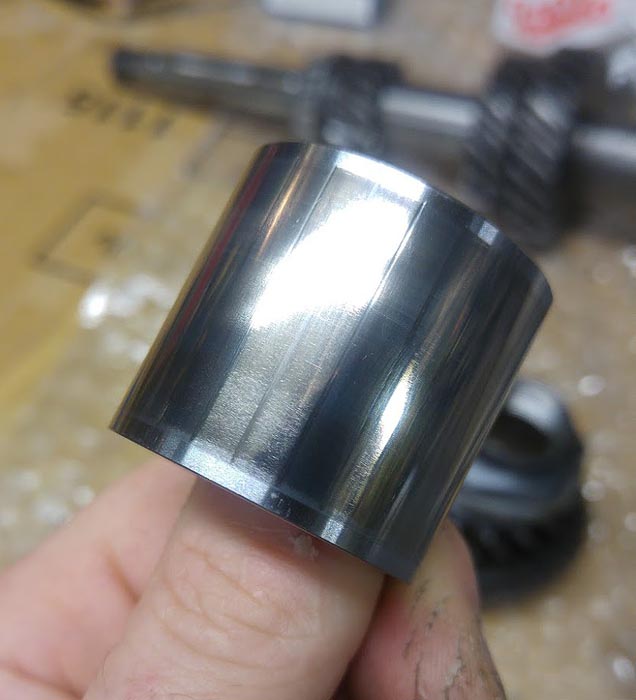

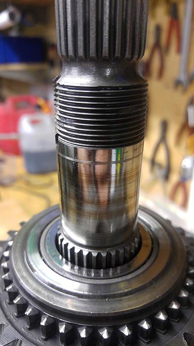

Those needle rollers run on a sleeve which is clamped in place by the big retaining nut: here's the previous assembly without the 5th gear in place.
You can see the sleeve just slips over the mainshaft so it's replaceable.
5th gear begins to fail when the retaining nut comes loose. The mainshaft twists as it transfers torque to the wheels, but the thrust washer and bearing sleeve are more rigid and don't twist as much. Eventually the retaining nut frets into the thrust washer and comes loose. Here you can *just* see the hexagonal marks where the nut has chewed into the thrust washer (I've ground both surfaces back a little before reassembly):
Once the nut is loose the bearing sleeve is no longer clamped in place, and when you're in any gear but 5th it will spin on the mainshaft (rather than staying still while the bearings rotate around it):
If the sleeve is free to spin, the needle rollers have no incentive to rotate and tend to rest in one position, brinelling (denting) the sleeve and making the sleeve spin even more.
Eventually the sleeve chews into the mainshaft, destroys the needle rollers, and breaks 5th gear. A new mainshaft is *not* cheap.
The proper way to prevent this would have been for Mitsubishi to grind a notch in the sleeve which engaged with a peg on the mainshaft, so even if the sleeve came loose it couldn't spin (like they did on the transfer case mainshaft). I guess you could add one by grinding a notch into the sleeve and mainshaft, but that would also create a stress-raiser, and I'm not brave enough to risk it. Instead I'm using retaining compound (Loctite for bearing sleeves) to glue the sleeve to the mainshaft, and regular loctite on the retaining nut.
I'll also be periodically removing the transfer case and checking that the mainshaft nut is still tight.

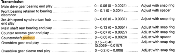

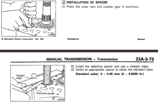

BEWARE! The workshop manual correctly states in the "technical data" table that the countershaft should have zero to 0.05mm preload:
Screen Shot 2019-01-04 at 19.36.53.png (61.95 KiB) Viewed 29593 times
The step-by-step instructions say only "obtain the standard value" of 0 to 0.05mm
Screen Shot 2019-01-04 at 19.36.29.png (78.14 KiB) Viewed 29593 times
You'll be checking the *clearance* of a whole bunch of components while you're rebuilding the gearbox. If you're not paying attention (and I wasn't) you might end up giving your countershaft 0.05 clearance instead of preload. Whoops.

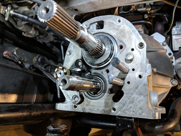

Even if the nut is loose, you can probably repair 5th by taking off the extension housing, saving you from having to remove the whole gearbox. You'd need a new needle roller bearing, sleeve, retaining washer, and nut. Oh and some retaining compound for the new sleeve (presuming the mainshaft isn't too far gone).

All the 5th gear work can be done with the gearbox in the van. If you have a KM145 consider removing the gearbox and replacing the input shaft bearing too, as they can be troublesome.

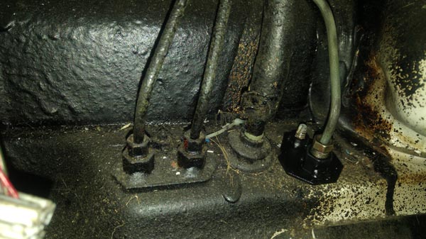

Gearbox wiring. I kept my existing automatic wiring. I had to connect the two large black wires together (black/yellow and black/white) to bypass the start inhibitor. I connected the manual gearbox's reverse switch to the blue and red/blue stripe wires. Because the manual gearbox is a bit shorter than the auto, I had to unwrap the wiring loom between the front fuel tank and the transfer case switches and re-wrap it to make it a bit shorter.
