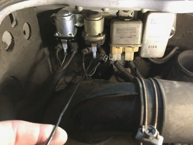

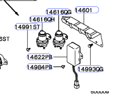

I recall the setup for the solenoids, but which one os 6 and which is 12?

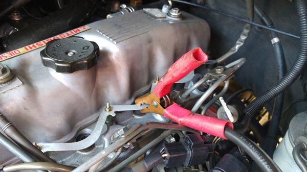

Thanks as well for the jumper tip, but before I electrocute myself am I basically taking jumper cables, grounding both negatives, then one positive lead on the battery and one on the bus bar (for 7 secs)? Also does it matter which battery I connect to if I'm running the dual battery setup?

14616QG is the 12V solenoid. This thread: http://www.delica.ca/forum/viewtopic.ph ... id#p133525 shows the glow plug solenoids, but TL:DR; to apply 12V to your plugs for fast warmup you want your manual button connected to the solenoid with the spade terminal, not the solenoid with the phillips screw. (That's the 6V solenoid, which is used to keep the plugs warm once the engine starts).
For the jumper test, you only need the red cable. One end to positive of one of your batteries, the other end to the bus bar like so:
Be very careful not to touch the alligator clip to anything other than the bus bar. If you touch the head you'll get some very exciting sparks, if you touch an injection pipe it's ruined. Maybe put insulating tape on the outside of the clamp's jaws, and tuck a sturdy rag under the bus bar (covering all the earthed metal around the area).

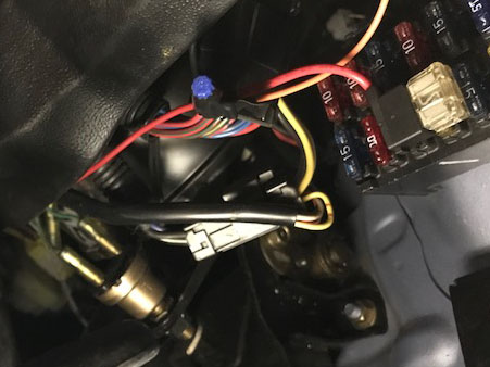

Okay, so didn't get to much tonight but I can show you guys a few things.
It appears my mechanic wired the button correctly, as the wire is running to the 6V solenoid. The negative wire runs to the fusebox at the firewall near the steering column. I didn't dig much further there.
Even after running the engine for a while (read: drive 8 miles home) after a hard start I tried the fuel pump primer one more time, it freely pumps up and down but no fuel comes out and it makes an air sound like it is not actually pumping....thinking this may be the culprit, though I'll get into glow plugs this weekend.

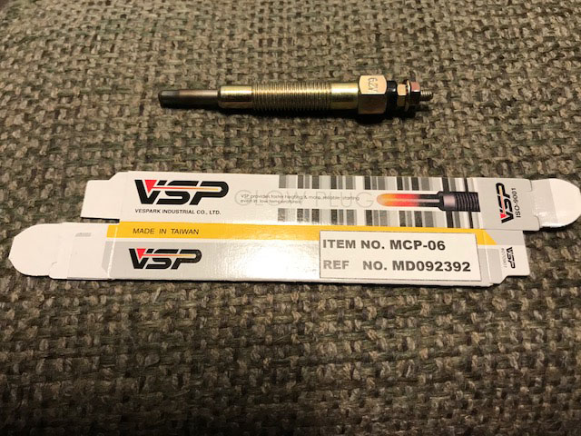

On that note reading through this forum has convinced me to buy OEM plugs, I do have these in the meantime though, has anyone used them?

The way you are currently set up you should hold the button for about 6 seconds (applying 12v) and then attempt the start. After/during start you may need to push the button *momentarily* to keep things going smoothly... this is where the system would normally switch over to a more sustained 6v glow cycle, but you can't do that.
The problem with manually applying 12v to 6v plugs is that it's easy to burn them out and you have no way of monitoring them. If you are running a manual switch only, I would probably switch to 12v glow plugs. You can still burn them out, but it's a lot less likely.
IDK anything about those plugs, but a quick search shows them as 6.2v and compatible. With a manual glow system there isn't any concern about compatibility requiring OEM plugs... that's about getting the ECU to work correctly.

The CP06 glow plugs will work fine with your 12V manual switch, but they may not be compatible with the ECU. If you reinstall the ECU you'll probably need to switch to Mitsubishi/Hyundai MD092392 or NGK 2161 (or let us know if those plugs also work).

I'm running the Hyundai MD092392 plugs with the ECU... seems to work fine and they were a lot cheaper.
