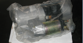

Re: Cold weather, starter issues?
I'll check the battery connections and the solenoid at the first opportunity. Only 2 things: what does the solenoid look like, and where is it located?

Hi Turf'd
The solenoid is a small canister attached to the starter. Take a look at this picture, not the best but I borrowed it from MaxOverdrive's site (thanks).
