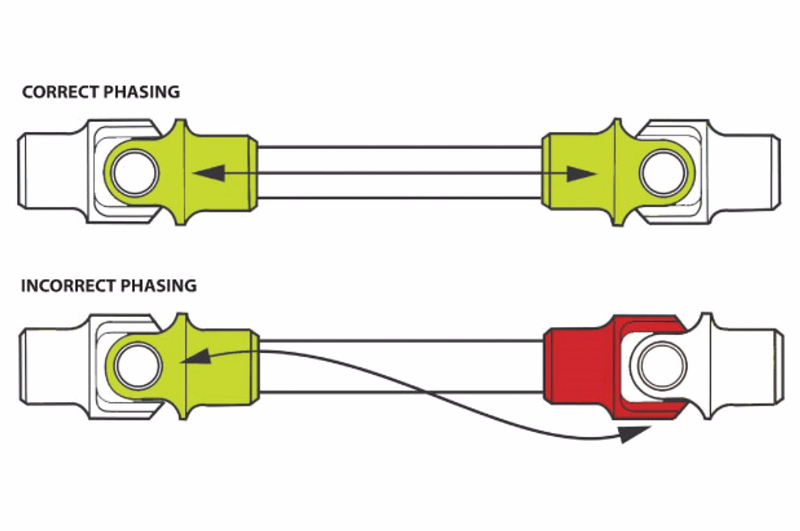

Incorrect phasing shouldn't cause clunks, but it will cause vibration which can destroy U-joints very quickly. The driveshaft on an automatic has a splined centre section, it's possible to reassemble it with the U-joints out of phase. Check that the U-joints at each end are aligned like so:
Because there's an odd number of splines, it's possible to assemble the driveshaft *almost* 180 degrees out, which to the casual glance looks like they're in phase, but if you hold a straightedge up to the caps you'll find one is about 4 degrees out.
