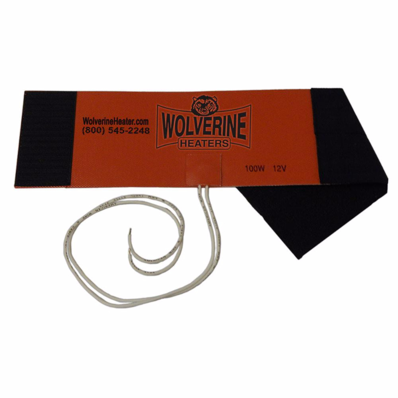

2. Oil pan heater. Same issue as 1.

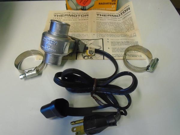

3. 12v Inline coolant heater. Not sure about effectiveness. Would the heated coolant flow through the pipes without a pump? Would the heat be sufficient?

Funny, I've heard of battery heaters, never a fuel filter heater. I'm in the market for solutions as well. Previous owners have installed an inline coolant heater - which needs to be plugged in (and sorted :? strange things). But I haven't really been able to see whether or not its effective yet. I kinda want as many solutions as I can get affordably so I'll able to do snowboarding trips without getting too anxious. Working on more trying issues currently.
