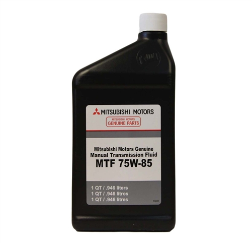

My search for 75w-85 oil for my L300's manual transmission and transfer case lead me to, well, my local Mitsubishi dealer. I bought five quarts of Mitsubishi MTF 75w-85 oil. There's nowhere on the bottle that it says GL-4 or GL-5, but I would assume this would be ideal for my '89 Delica.
I know it's recommended for a host of Mitsubishi-made vehicles, such as the EVO, 3000GT, and Eclipse.
Before I drain and fill with this stuff, can someone tell me if this is indeed the oil to use?

It was about $15.50 usd per quart. I figure it's got to be GL4 if it's for a manual transmission.

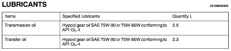

sk66
Posts: 189
Vehicle: '91 Delica L300
Location: Pennsylvania, USA
Mitsubishi 75w-85 Oil (Diaqueen)
Post by sk66 »
The sticker would be on the rear diff filler plug, but they go missing easily. You can jack both rear wheels in the air and then rotate one forward... if the other turns forward it is an LSD, if the other turns backwards it is not. Or you can just get into some mud/soft ground and see if it will dig dual ruts :-D .
If it's non LSD, then the transfer case should use the same oil as the transmission.
From the manual (for manual transmission/non-LSD).
