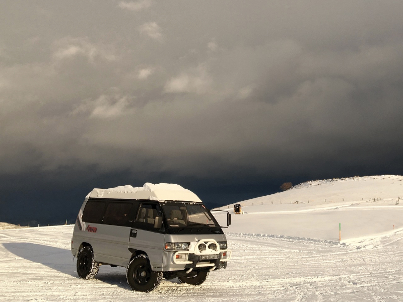

I'm running 16x8 0 offset wheels with 235/85 cooper at3's. the 16x8 and 0 offset fills the fenders perfect and it feels more stable to me now on highways/windy roads, they're stealth custom series f5's, they're super light so acceleration didnt seem to suffer. I did have to trim my front fenders a little, but not much.
regardless i think the 16x8 0 offset is the way to go.

Mr.SA wrote:I'm running 16x8 0 offset wheels with 235/85 cooper at3's. the 16x8 and 0 offset fills the fenders perfect and it feels more stable to me now on highways/windy roads, they're stealth custom series f5's, they're super light so acceleration didnt seem to suffer. I did have to trim my front fenders a little, but not much.
Pics? Are you lifted? The F5s are my favorite off-road wheels!

Not the best pic of the wheels but gives you an idea of how they fit the wheel wells. I just cranked up the torsion bars a tad in the front, which i dont think put it over stock height since the front seemed to be sagging. stock height in the rear.

Looks great. I can't believe you don't rub! I figured for sure it'd rub with a 16x8 and 0 offset, especially with 235s. Would love to see more pics if you have them at some point.
